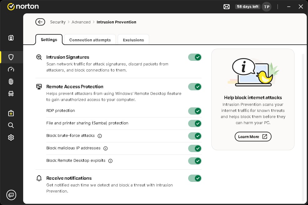

I don’t think its specifically an RDP issue, when I get certain notifications and try doing a screen capture the notification always gets hidden until I close my capture app. Then it reappears. The settings shown below are the only areas where I can see that may be of help. These new version releases are not user configurable in the ways Norton was before them.
