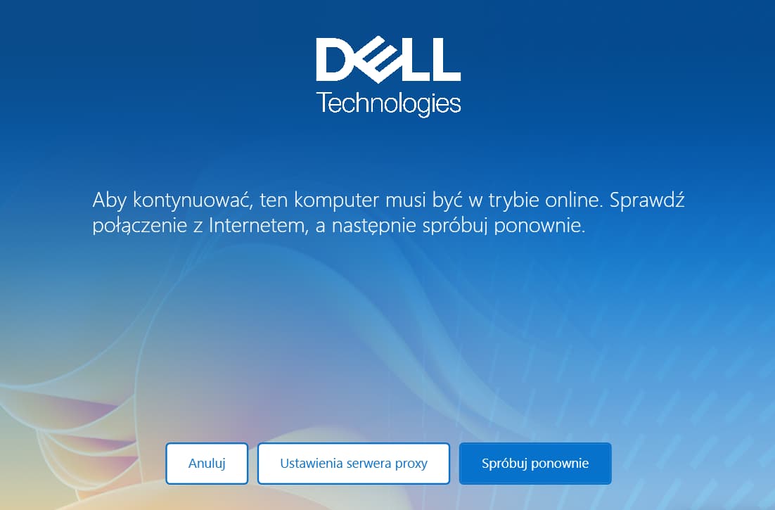

There’s not much to show. I tried installing the new version of Dell Supportassist 4.10.1 multiple times, and each time, the installer froze at the beginning of the installation. After analyzing its logs, I determined that it couldn’t see a connection to the installation server. So I disabled the Norton Firewall. That helped. The installation went smoothly.

2025-09-18 16:36:06,513 [4.10.1.42635] [12632 - 13] ERROR Dell.SupportAssist.Client.DownloadManager.DownloadManager - Exception at GetHttpResponseMessageAsync Wystąpił błąd podczas wysyłania żądania.
2025-09-18 16:36:06,514 [4.10.1.42635] [12632 - 13] ERROR Dell.SupportAssist.Client.DownloadManager.DownloadManager - The download of the SUPPORTASSISTAGENTCATALOG.CAB file got aborted due to an internal error: Wystąpił błąd podczas wysyłania żądania.
2025-09-18 16:36:06,515 [4.10.1.42635] [12632 - 13] ERROR Dell.SupportAssist.Client.AutoUpdateUtilities.AutoUpdateWrapper - Download of https://saupdates.dell.com/serviceability\catalog\SUPPORTASSISTAGENTCATALOG.CAB failed due to Wystąpił błąd podczas wysyłania żądania.
2025-09-18 16:36:06,515 [4.10.1.42635] [12632 - 7] ERROR Dell.SupportAssist.Client.SupportAssistInstaller.AutoUpgradeHelper.CheckForAutoUpdate - Catalog download failed. Exiting the process.
2025-09-18 16:36:06,515 [4.10.1.42635] [12632 - 7] INFO Dell.SupportAssist.Client.SupportAssistInstaller.ViewModel.MainViewModel - No internet available.

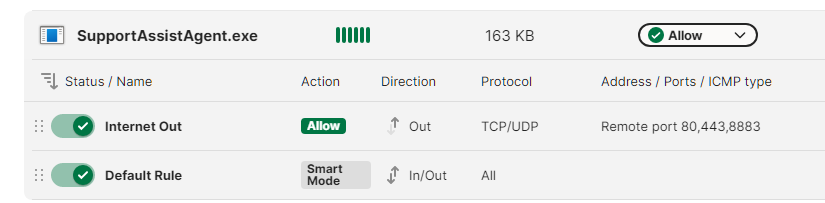

When Norton firewall is on:
Internet works for other applications.

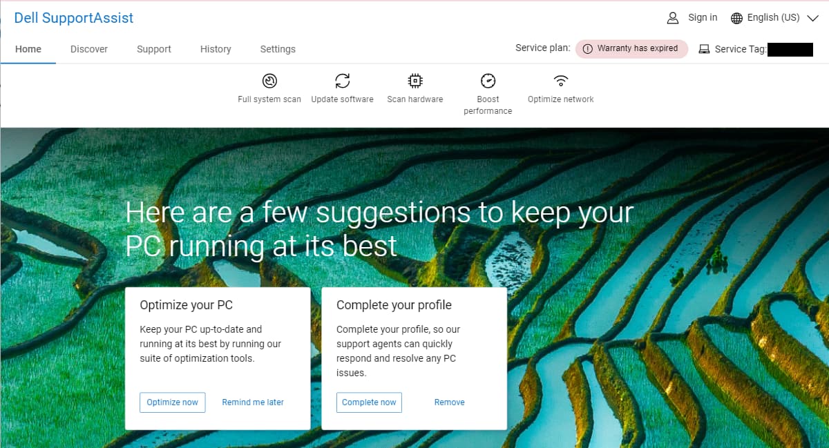

fwiw ~ from my old dust collector Dell machine
https://downloads.dell.com/serviceability/catalog/SupportAssistinstaller.exe
