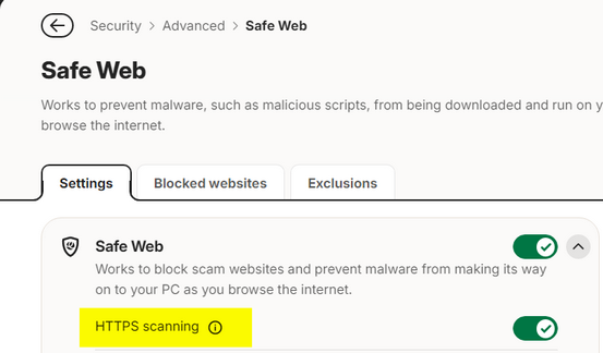

as test, disable SafeWeb/HTTPS scanning (not just the firewall) for 5 minutes and try again.
fwiw ~ as test: HTTPS scanning – enabled

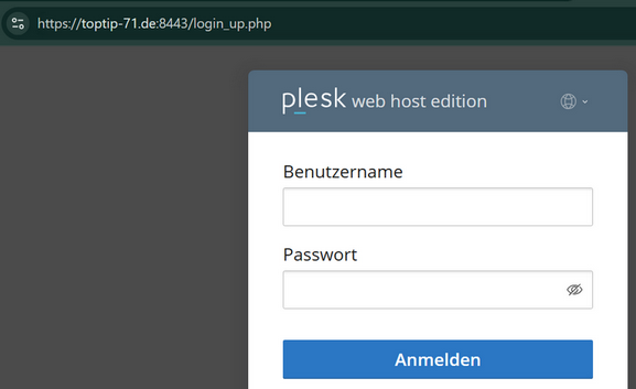

https://toptip-71.de:8443/login_up.php

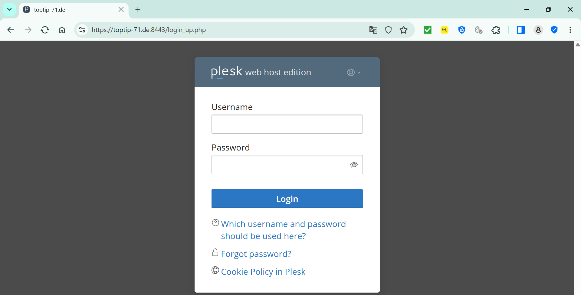

Caveat: I’m not behind Sophos gateway

Since the second user can open the page perfectly, but the original poster (OP) gets blocked, the blame shifts entirely to the Sophos gateway found in the OP’s Wireshark log.
Here is exactly what this clue tells us about the block:
The Server is Innocent
The server toptip-71.de is active and accepting connections on port 8443.
It is not blocking modern Google Chrome browsers.
It is not throwing a global server error.
