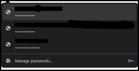

The issue is that Google Chrome’s autofill function only suggests passwords when the Norton Password Manager extension is enabled, whereas it suggests passkeys and passwords when it is disabled or not installed. Similarly for Microsoft Edge and its autofill function.
Here are some screenshots demonstrating what Chrome’s autofill does when I click on an e-mail field on a website that supports passkeys and I have passkeys registered with it.
When Norton Password Manager is disabled:
When Norton Password Manager is enabled:
The reason for the difference with what you are seeing is that Norton PWM or Chrome PWM should NOT be used side-by-side. One will default over the other when used. Passkeys as Guru peterweb said are not supported in the current releases of Norton PWM therefore will not show as an option. Since using PWM will make it default it may also block your browsers built in settings from allowing usage. I sure hope that changes in the future due to the changes Google is making with device fingerprinting. Hope that helps.
