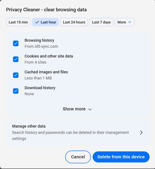

Just installed Norton Private Browser and figuring out how it works under the “Privacy and Security” setting’s “Third Party Cookies” options; which was set to its default install.

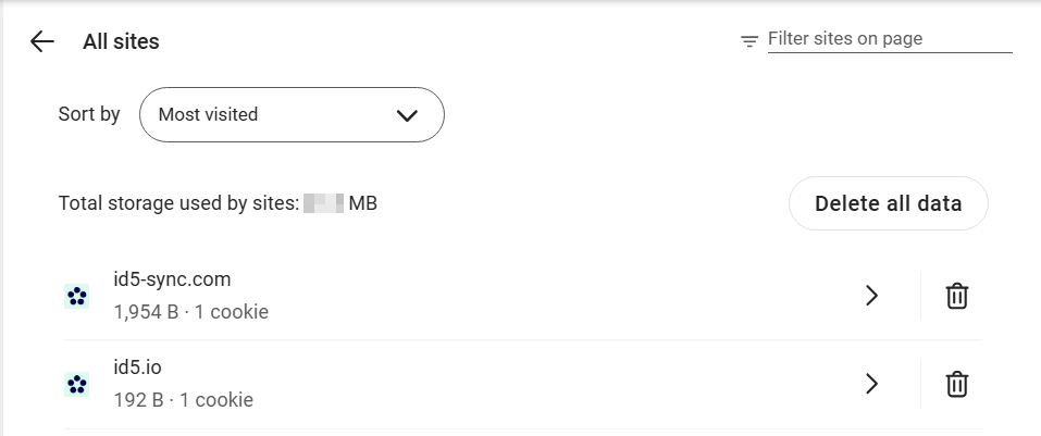

I was shocked to find the browser allowed third party cookies from id5-syncDOTcom listed after clicking “See All Sites and their permissions” at the bottom of the Third Party Cookies options page. I searched “what is id5-syncDOTcom”. It is not a secure site or service. I expected Norton Private Browser to have tight basic controls, so a little bit disappointed.
Questions:
How do I
a) remove that cookie
b) set the Browser’s cookies options to exclude specific undesirable cookies that I find?
Thank-you.

Hello @PurpleOrange
A clean install of Norton Private Browser actually allows third-party cookies in the standard Settings menu by default.
While Norton is marketed as a privacy-first browser that “blocks trackers by default,” it handles this through a dual-layer system that can be confusing:
The Settings Layer (Standard Chromium)
In the main menu (Settings > Privacy and Security > Site Settings > Cookies), the default state is often set to “Allow third-party cookies”. This is done to ensure that websites don’t “break” immediately after installation, as many sites rely on these cookies for basic functionality like embedded videos or support chats.
The Privacy Guard Layer (Norton’s Protection)

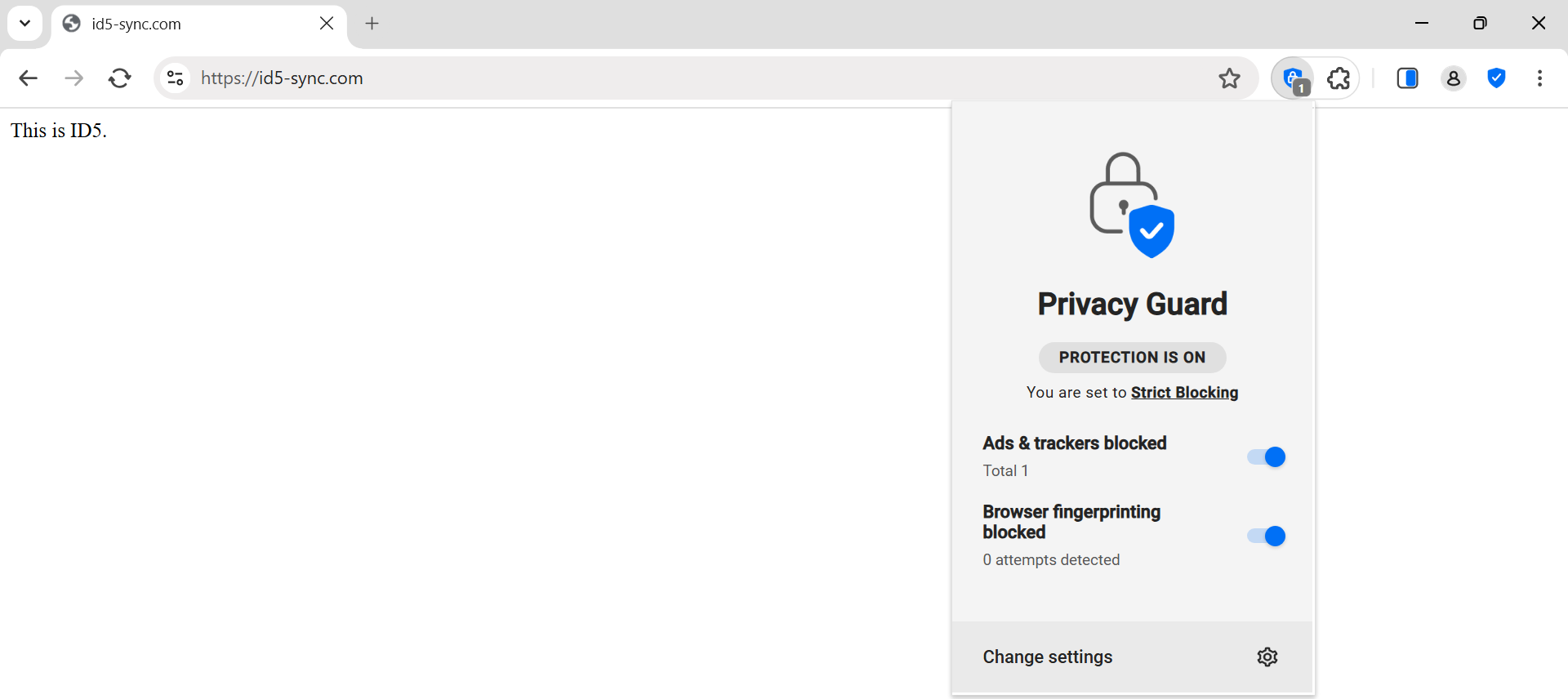

The actual blocking happens in the Security & Privacy Center (the blue shield icon.
Privacy Guard is enabled by default upon a clean install.
It operates as a filter on top of your browser settings. Even if the standard settings say “Allow,” the Privacy Guard actively strips out known tracking cookies before they can reach your browser.
Why you might see “Allow” in Settings:
Compatibility: A total block in the core settings is more likely to cause site errors than Norton’s targeted tracker-blocking list.
Targeted Blocking: Norton’s default “Balanced” mode specifically targets “ad trackers” rather than every single third-party cookie, which is why the global “Allow” toggle in Settings remains active.
To confirm your protection, you should check the Shield Icon rather than the standard Settings page. If Privacy Guard is set to Balanced or Strict, you are being protected regardless of what the main Settings menu says.
Norton Private Browser blocks third-party cookies and ad trackers by default to prevent cross-site tracking.
Unlike standard browsers, it uses several built-in tools to manage your privacy automatically:
Privacy Guard: This feature limits tracking cookies by default. You can adjust these settings by clicking the shield icon in the top-right corner to toggle between Basic, Balanced, and Strict blocking modes.
Cookie Consent Manager: This tool uses AI to automatically handle cookie pop-ups. It tries to select the most privacy-friendly option (like “Deny All”) so you don’t have to manually click through banners.
Private Mode: Opening a window in Private Mode (similar to Incognito) ensures that any tracking cookies or caches acquired during that specific session are deleted as soon as you close the window.
While it blocks many tracking cookies, Norton notes that some specialized cookies may still be accepted if a website’s consent banner is unrecognized or if strict blocking is not enabled, as certain sites require cookies to function properly.
Ensure Privacy Guard is toggled ON .
Set the protection level to Balanced or Strict to ensure third-party tracking cookies are restricted.

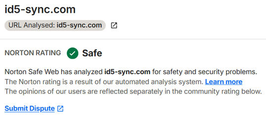

netcraft - Site report for https://id5-sync.com
id5-sync.com is a domain used by ID5 https://id5.io/, an identity platform for the digital advertising industry. It is primarily a technical infrastructure used to “sync” or match user identifiers between different advertising platforms.

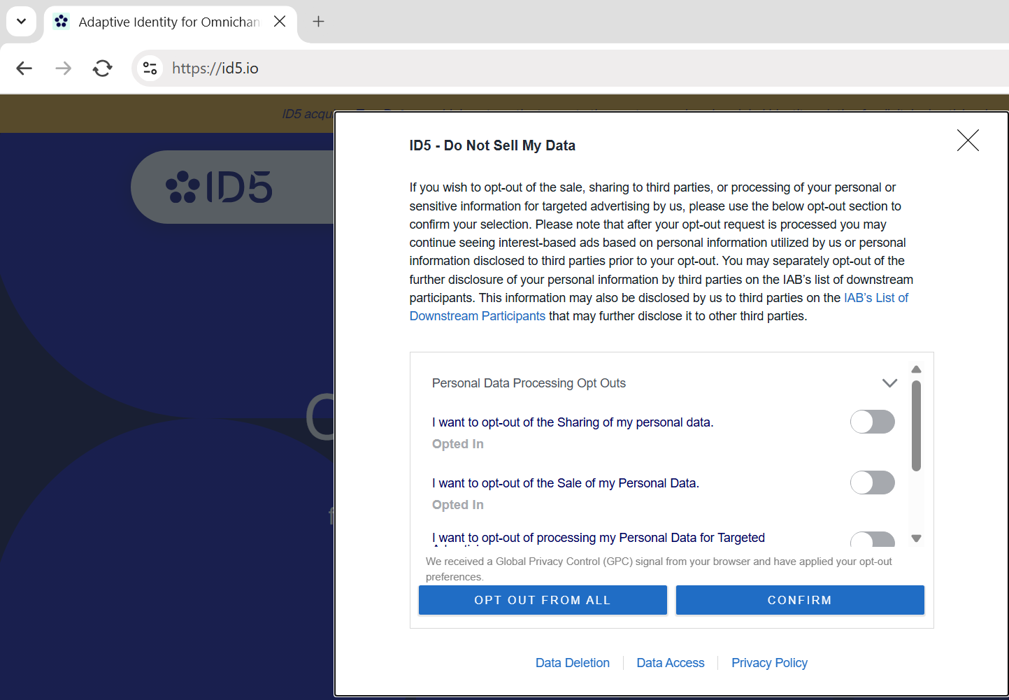

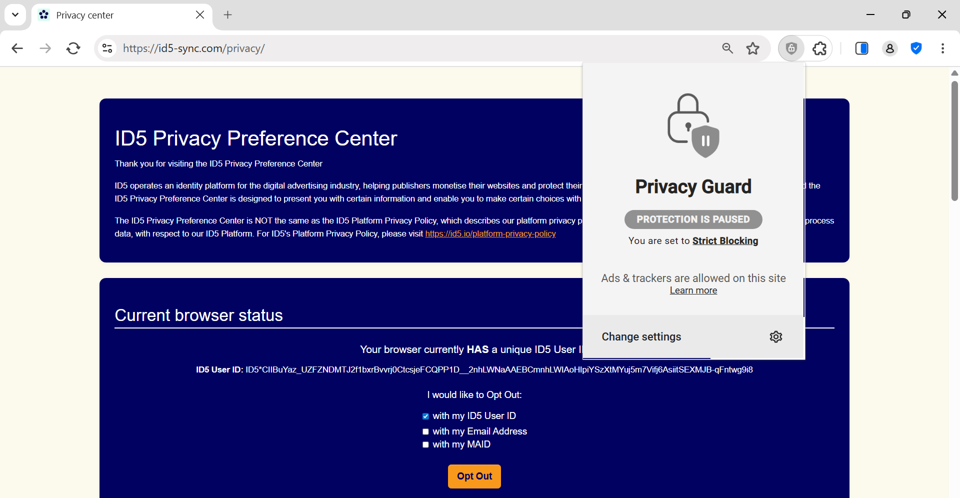

Opt-Out: Users can manage their preferences or opt-out of ID5’s tracking directly at the ID5 Privacy Preference Center https://id5-sync.com/privacy/.

secure://settings/clearBrowserData
secure://settings/content/all
