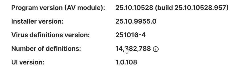

Oh, so it’s not only me. Norton UI CONSTANTLY steals the focus and it’s really really annoying. I am also using the latest version (25.10.10528 (build 25.10.10528.957)

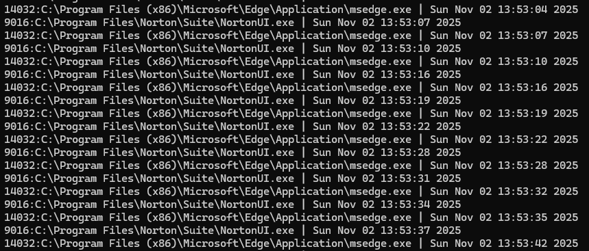

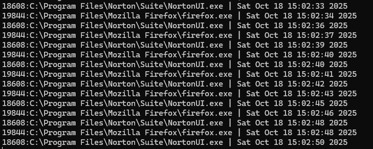

Same problem here, Nortonui.exe is stealing focus every few seconds. Typing a message is a chore like this:
I have updated Windows 11 to 25H2 and Norton to 25.10.10528 (Build 25.10.10528.0).
If the Norton 360-Window is open, the problem disappears, at least for a while, although the focus stealing is sometimes still happening according to the focus-monitor.exe, especially directly after switching apps.

Today it’s gotten worse - even with the UI open the active app loses focus multiple times per minute:

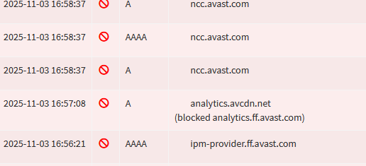

Hi @Tarin, and those similarly affected. I’ve managed to stop this focus theft here, but I’m currently unsure of the consequences of my ‘fix’. @Salty was on the money wrt http://ipm.avcdn.net/ .
Turns out, from limited research I’ve done, that our AV now uses the Avast engine. The Avast firm has been fined for tracking and selling customer data. avcdn.net is Avast.
I tried to block that url on my pc by adding it to my hosts file, resolving it to localhost - every time I tried the AV undid my change (cheeky!).
I now have that url blocked by my router and the focus theft has gone. I’ve written this post without once having to backtrack :slight_smile:
The NortonUI now takes a little while longer to load, but no longer tells me there are 1mill+ fixes I could apply by upgrading.
LiveUpdate runs ok but I’m waiting for some updates to apply before being ‘happy’ with my ‘workaround’.
@smokin365 I have tested a little as well - starting/logging into Windows once with our pi-hole inactive (temporarily not blocking anything, so sort of the opposite of your blocking the avast analytics/telemetry stuff) might have helped a bit? At least after rebooting and switching off and on the computer, Norton didn’t immediately start grabbing focus, even when working online for a couple of minutes. There are quite a lot of calls to avast/avcdn being logged/blocked, so this could definitely be related to the issue.
Maybe it needed some data from ‘home’ which it could not get, and calmed down somewhat after being allowed to phone home once.

Found out that it has been trying to access multiple addresses like analytics .avcdn.net, avcdn. net, overseer. tools. avcdn. net, etc. I’ve disabled it on my DNS, disabled it at my router but it doesn’t seem to fix the issue with NortonUI stealing focus for 1 second. As far as it seems - the only way to fix it is to uninstall it.

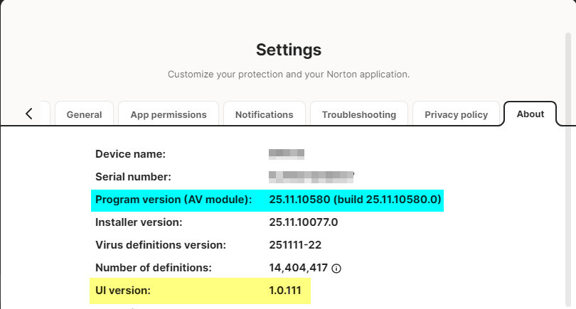

Norton Security 25.11.10580 for Windows is now available!
https://community.norton.com/t/norton-security-25-11-10580-for-windows-is-now-available/469184
UI Version: 1.0.111 has been released to fix the issue of “Norton360 Makes Keyboard unusable - constantly grabs focus”. Please run Norton LiveUpdate and Restart the system to check if the fix is working.
Everyone: The latest version release notes state this has been fixed. Have any of you ran live update with Norton, received the latest release and retested as Guru bjm suggested?
  • Bug fixes for the below issues:
