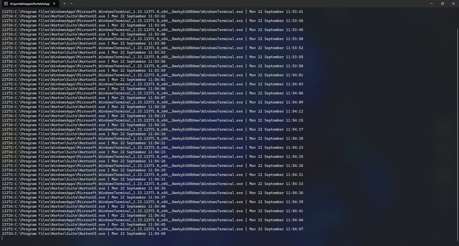

I first checked if my keyboard was sending erroneous keystrokes and it wasn’t. So then I came up with a Nodejs script that queries a Windows API to check which window has focus. See: Pastebin / z2Xjsrrs
And what I see happening is the following:
Focus changed:
Title : Minecraft
PID : 27904
EXE : C:\Windows\System32\ApplicationFrameHost.exe
Time : Mon Dec 23 2024 22:47:41 GMT-0600 (Central Standard Time)
Focus changed:
Title : Norton 360
PID : 19560
EXE : C:\Program Files\Norton\Suite\NortonUI.exe
Time : Mon Dec 23 2024 22:47:42 GMT-0600 (Central Standard Time)
Focus changed:
Title : Minecraft
PID : 27904
NortonUI.exe briefly takes focus before returning it to the original process.

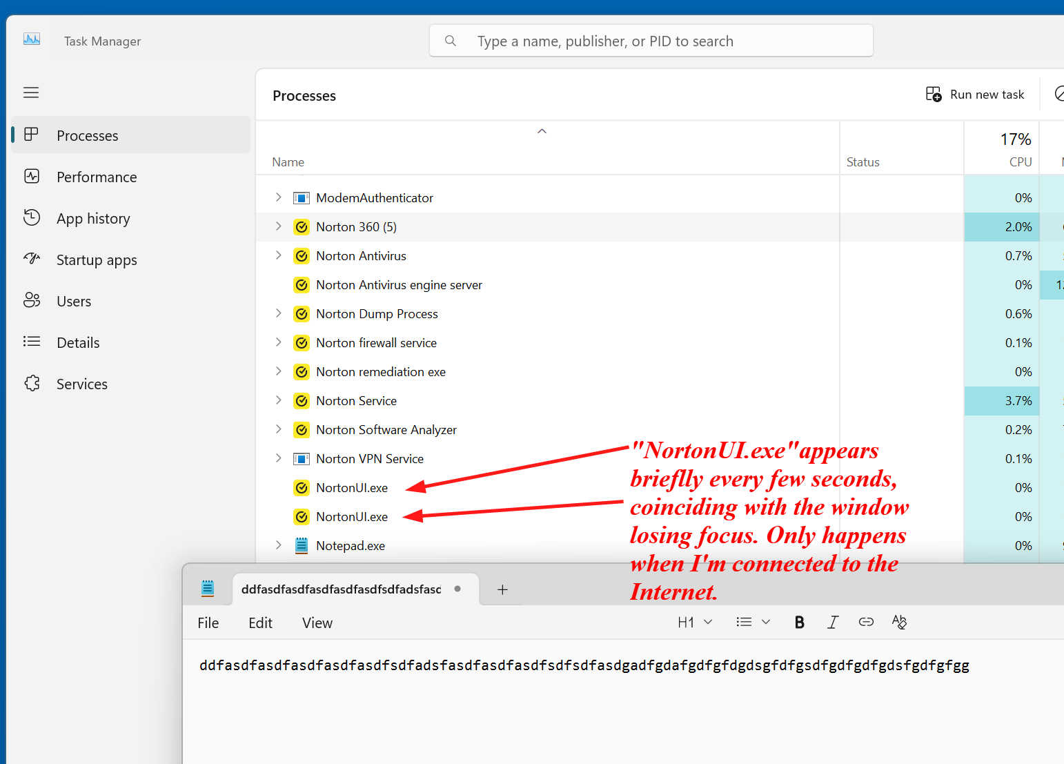

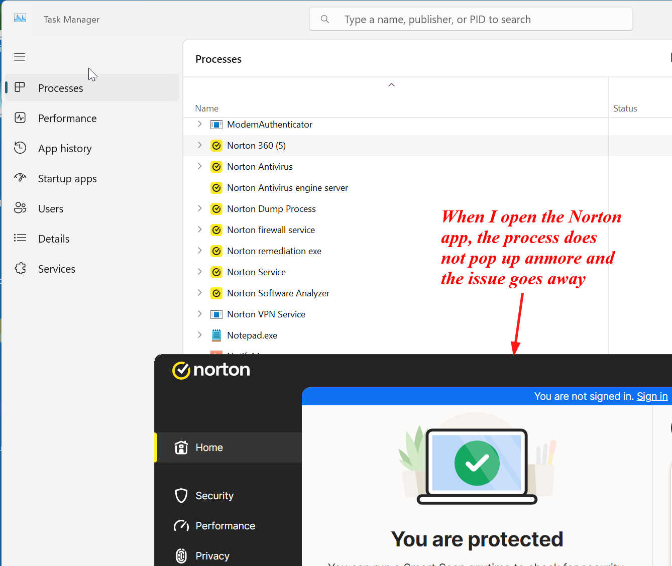

I just noticed that the issue goes away when I open the Norton app and leave it open.
I noticed that there is a processes “NortonUI.exe” that briefly pops up every few seconds in the task manager when:
  1. I DO NOT have the Norton user app open and
  2. I’m connected to the Internet.
The appearance of the “NortonUI.exe” process in the task manager coincides with the window losing focus. When I open the Norton UI the process does not pop up anymore and the window does not lose focus anymore.
So for right now my solution is to leave Norton open while I’m working.

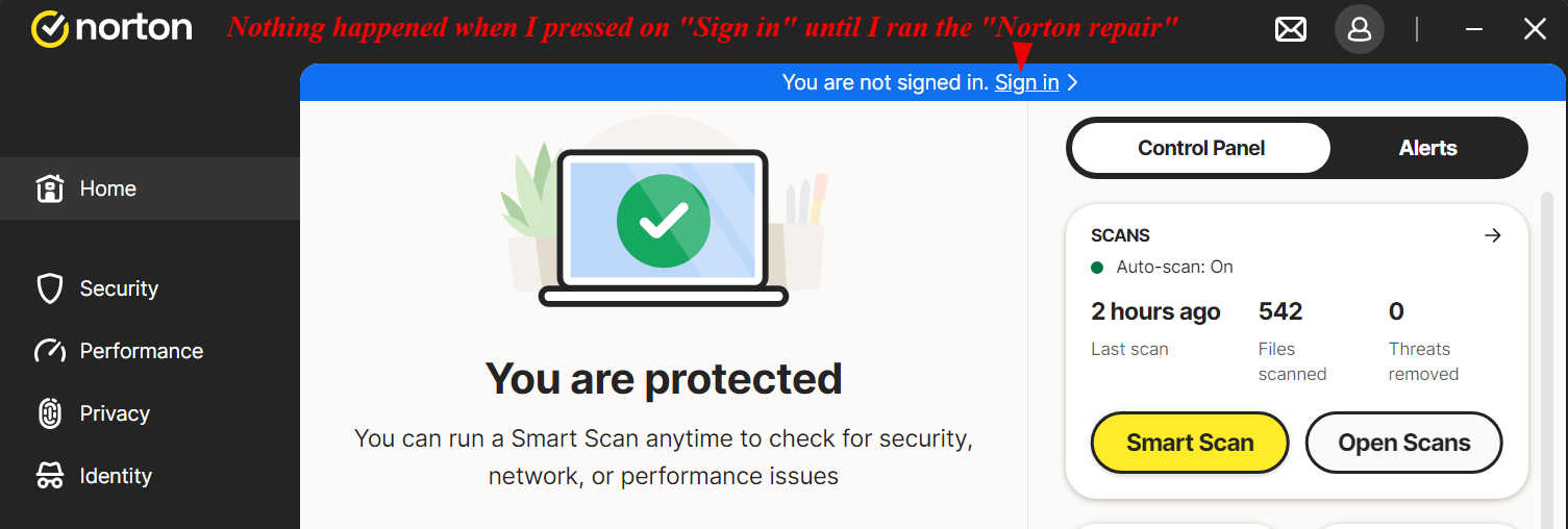

I was able to solve it. The underlying issue was that Norton could not automatically sign me in. Apparently that triggered the NortonUI.exe to keep popping up, which caused my window to lose focus every few seconds.
The sign-in issue was odd:
When I opened the Norton UI there was a link on the top “You are not signed in. Sign in” even though everything was working fine. Pressing the link did not do anything. I did the following:
  1. Ran live update to update to the latest version
  2. Ran “Repair Norton” under Settings > Troubleshooting tab
  3. I was eventually able to use the “sign in” link after disabling the Firewall and closing and opening the Norton UI repeatedly (not sure what exactly did the trick)
    After signing in successfully the issue with losing focus finally went away. I hope this helps someone else.

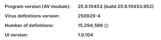

Finally, yesterday I’ve decided to reinstall Norton360 and give another try with support, but there was no need, it worked! I’ve been using the computer with no problem for the last 24 hours.
I don’t know if the problem is fixed in this version (screenshot), or if it was because as soon as the program finalized installing and before the setup window my internet failed, and I didn’t go through that setup because the window was blank.
Whichever happened, I have one thing less to worry about, at least for the moment.
Yes, something changed. I don’t have the issue either anymore. At some point I noticed that I wasn’t losing focus anymore despite the Norton UI being closed. I didn’t change anything after the last time it happened but maybe there was a background update that fixed it. Fingers crossed…
