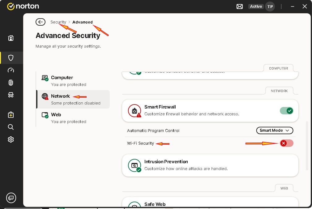

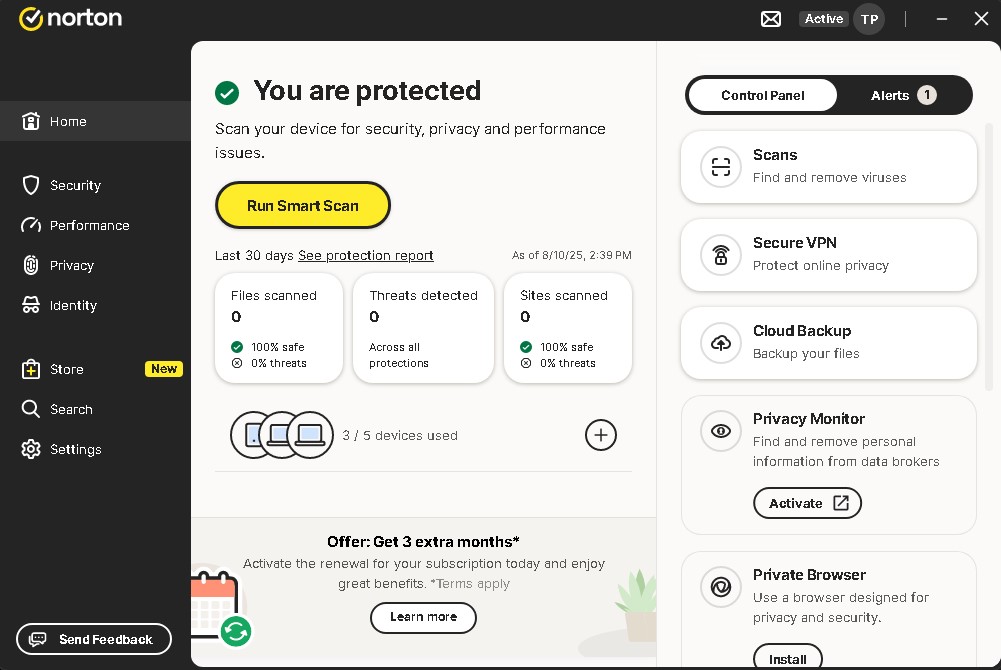

All: I am once again using the latest release version 25.7.xxx, the Home area no longer shows anything related to connection type in this release. Are you guys on the latest release for test?
When I setup the new version I disable Wi-Fi scanning.
Norton no longer is changing my wired connection to public at boot, restart or otherwise.
