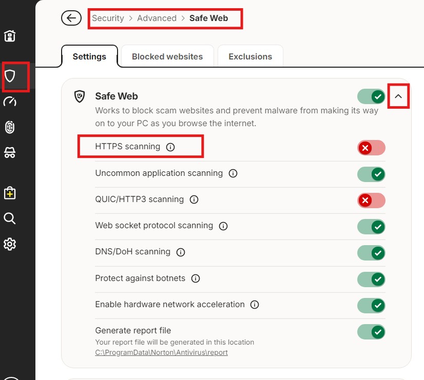

Try just turning off the HTTPS scanning within the Safe Web feature. From the main Norton interface click Security on the left side, then click on Advanced Security. Scroll down to and click on the Safe Web feature. Click on the down arrow beside the button to turn on/off the feature and then turn off HTTPS scanning. Then test your website access again.
That fixed it. Thank you so much!
The weird thing about the issue was that it only had issues when using an ethernet cable. Not when I used WIFI.
Sorry, I don’t have that kind of information for you. Maybe someone with more detailed knowledge of networking can help.
@SoulAsylum ?
I spoke too soon. After a reboot it went back to being slow. I guess it takes a reboot for the safe web changes to take affect. I am going to try turning off QUIC/HTTP3 scanning like in your example and see if that works.
