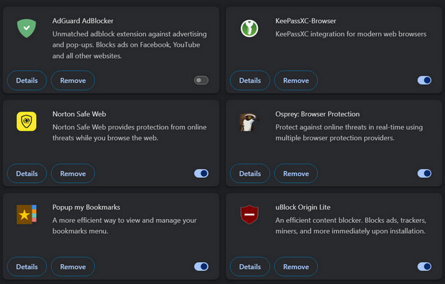

Those are the only other plugins that had been active in parallel to the Norton plugins.
However, deactivating and reactivating those one by one did not change anything.

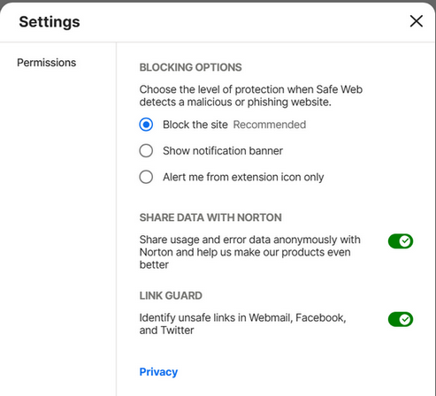

fwiw ~ my Norton Safe Web extension > Settings are default

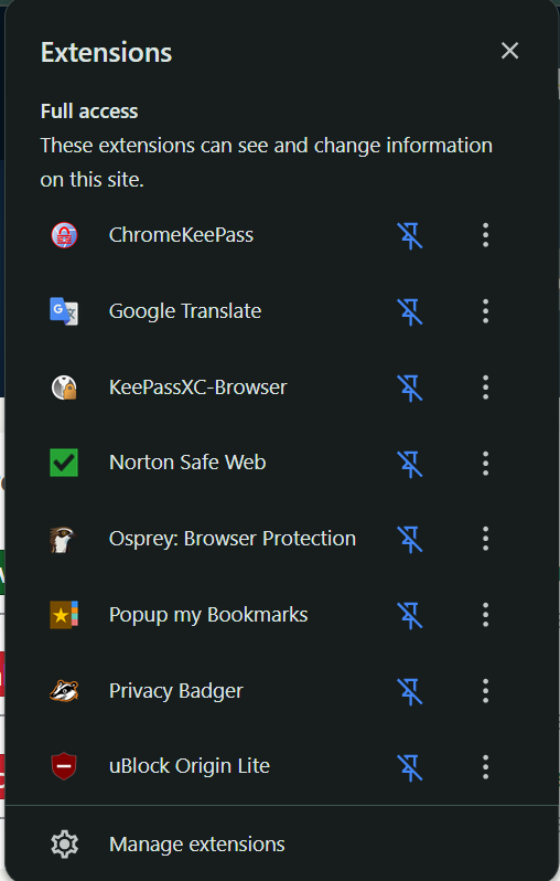

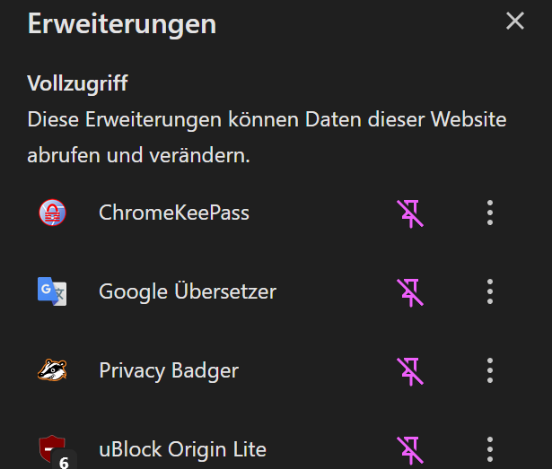

as test: added Google Translate | Privacy Badger | ChromeKeePass … with 20 open tabs
Caveat: I run KeePassXC
