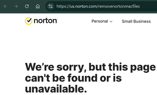

To fix the blocking while keeping Norton installed, the most effective method is usually a clean removal of the Network Extension using the official Norton removal tool, followed by a fresh installation where you carefully re-grant the “Allow Filter” permission when prompted by macOS.
Note: I don’t know whether the "official Norton removal tool for Mac…is still offered.
Uninstall your Norton device security product on Mac
It appears Norton has redesigned their support page to remove the direct links to the advanced script, likely to push users toward their standard uninstaller. However, for the Content Filter loop you are experiencing, the standard uninstaller often fails because it cannot “force” macOS to release the network extension.
Since the “Need more help” section is missing from your view, here is the direct, official download path and the manual alternative to fix this.
:inbox_tray: 1. Direct Download (Copy/Paste this)
Since you cannot find the link on the page, copy and paste this direct URL into your browser address bar. It is the official Norton shortcut to the script:
https://norton.com/removenortonmacfiles
:hammer_and_wrench: 2. If the download doesn’t start (Manual Terminal Fix)

Summary of your next move: Try the norton.com/removenortonmacfiles link first. If that doesn’t download the zip, use the Terminal commands above. Either way, you must restart your Mac after running them to clear the “Content Filter” from your Network Settings once and for all.
:hammer_and_wrench: Direct Fix: Manual Removal via Terminal
Since the Norton support pages are currently broken and the download link is unavailable, you can perform the exact same action as the advanced script by using the macOS Terminal. This will force-remove the “Content Filter” that is blocking your internet.

  3. The “Hidden” Tool: As you found, their web links for the dedicated tool are currently broken or redirected. Even a support agent might struggle to provide a working link if their internal knowledge base hasn’t been updated to reflect the broken web page.
