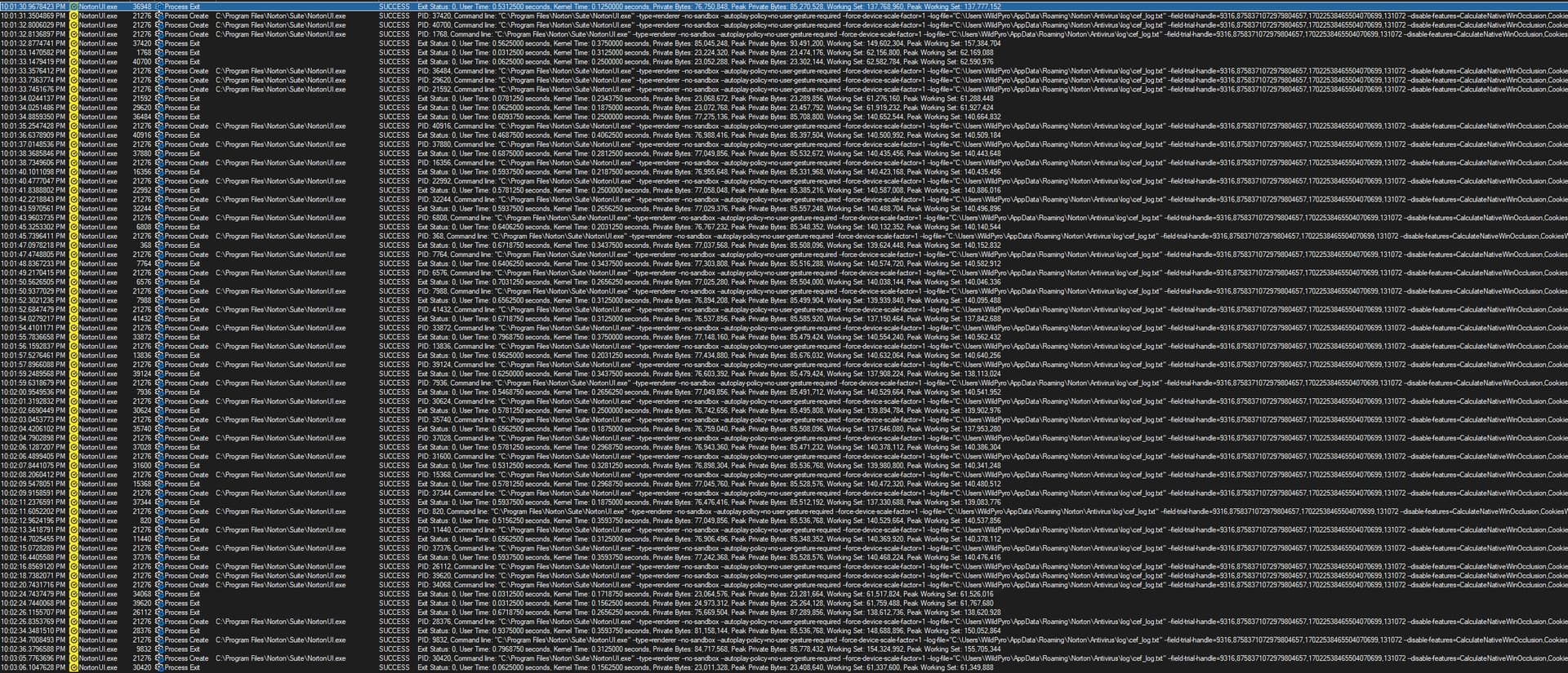

Over the last few weeks or so this problem has been getting progressively worse. It started with my mouse/keyboard losing focus because something was opening /closing in the background and it would only happen every few minutes or so. It then progressed to every 30 seconds and just last night it was happening rapid-fire, multiple times a second where I couldn’t even use my PC. These logs from Process Monitor were taken just last night in a matter of 3 seconds:

Command line: “C:\Program Files\Norton\Suite\NortonUI.exe” --type=renderer --no-sandbox --autoplay-policy=no-user-gesture-required --force-device-scale-factor=1 --log-file=“C:\Users\WildPyro\AppData\Roaming\Norton\Antivirus\log\cef_log.txt” --field-trial-handle=9316,8758371072979804657,17022538465504070699,131072 --disable-features=CalculateNativeWinOcclusion,CookiesWithoutSameSiteMustBeSecure,SameSiteByDefaultCookies,SameSiteDefaultChecksMethodRigorously --disable-gpu-compositing --lang=en-US --log-file=“C:\Users\WildPyro\AppData\Roaming\Norton\Antivirus\log\cef_log.txt” --log-severity=verbose --user-agent=“Mozilla/5.0 AppleWebKit/537.36 (KHTML, like Gecko) Chrome/91.0.4472.101 Safari/537.36 Avastium (0.0.0) (Windows 10.0)” --disable-webaudio --force-wave-audio --disable-software-rasterizer --no-sandbox --blacklist-accelerated-compositing --disable-accelerated-2d-canvas --disable-accelerated-compositing --disable-accelerated-layers --disable-accelerated-video-decode --blacklist-webgl --disable-bundled-ppapi-flash --disable-flash-3d --enable-aggressive-domstorage-flushing --enable-media-stream --disable-gpu --disable-webgl --disable-gpu-compositing --allow-file-access-from-files=1 --force-device-scale-factor=1 --pack_loading_disabled=1 --device-scale-factor=1 --num-raster-threads=4 --enable-main-frame-before-activation --renderer-client-id=6570 --mojo-platform-channel-handle=13300 /prefetch:1
Any idea what this is and how to disable it? I have already tried removing Norton using the NRnR.exe tool multiple times but it just keeps coming back after a few hours of stability. I’m at my wits end.

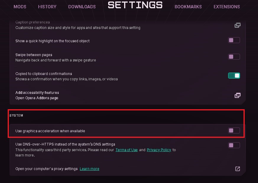

I use Opera GX which is Chromium based, it too has an acceleration setting which I keep disabled to prevent issues like the one you are experiencing. Users with different hardware and usage types may not become affected, while some will. My suggestion, as a test would be to disable GPU acceleration, reboot the computer and allow time to recheck for the issue persisting.
Edited: I use a dedicate GPU in this computer which performs the GPU acceleration at the system level vice a browser, zero issues.
Thanks, I turned it off and rebooted. The toggle was the same exact wording in Chrome, I found it in Settings>System. I’ll let you know how I turn out!

It appears my problem is solved. Thank you for the help!!

Sorry to bring up an old post, but this started happening when I confirmed that all my browsers (Including Edge and Firefox) have hardware acceleration disabled. Any other ideas as to why this might be happening? It’s really becoming a nuance.
-Pyro
This is literally after a fresh reboot, no other programs running except for Procmon:
