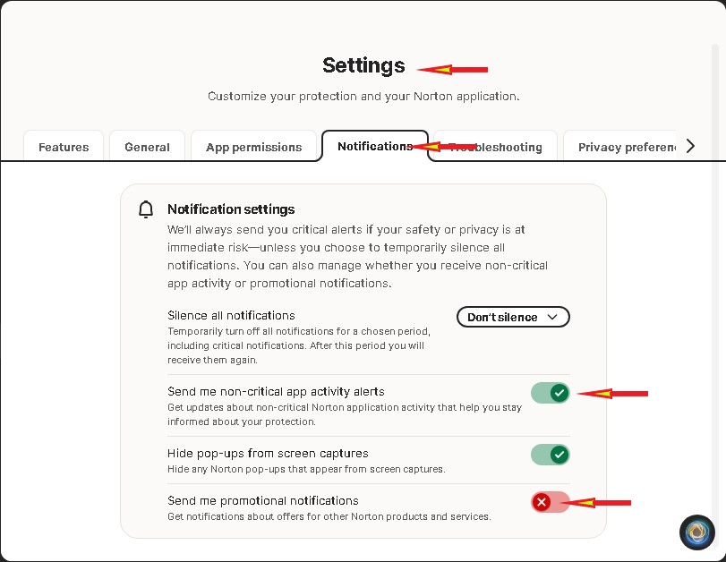

@New_Style_xd Please post a screenshot of where you are seeing “Administrative Settings” appear in your Norton 360 UI. I’m not seeing those with the current version release.

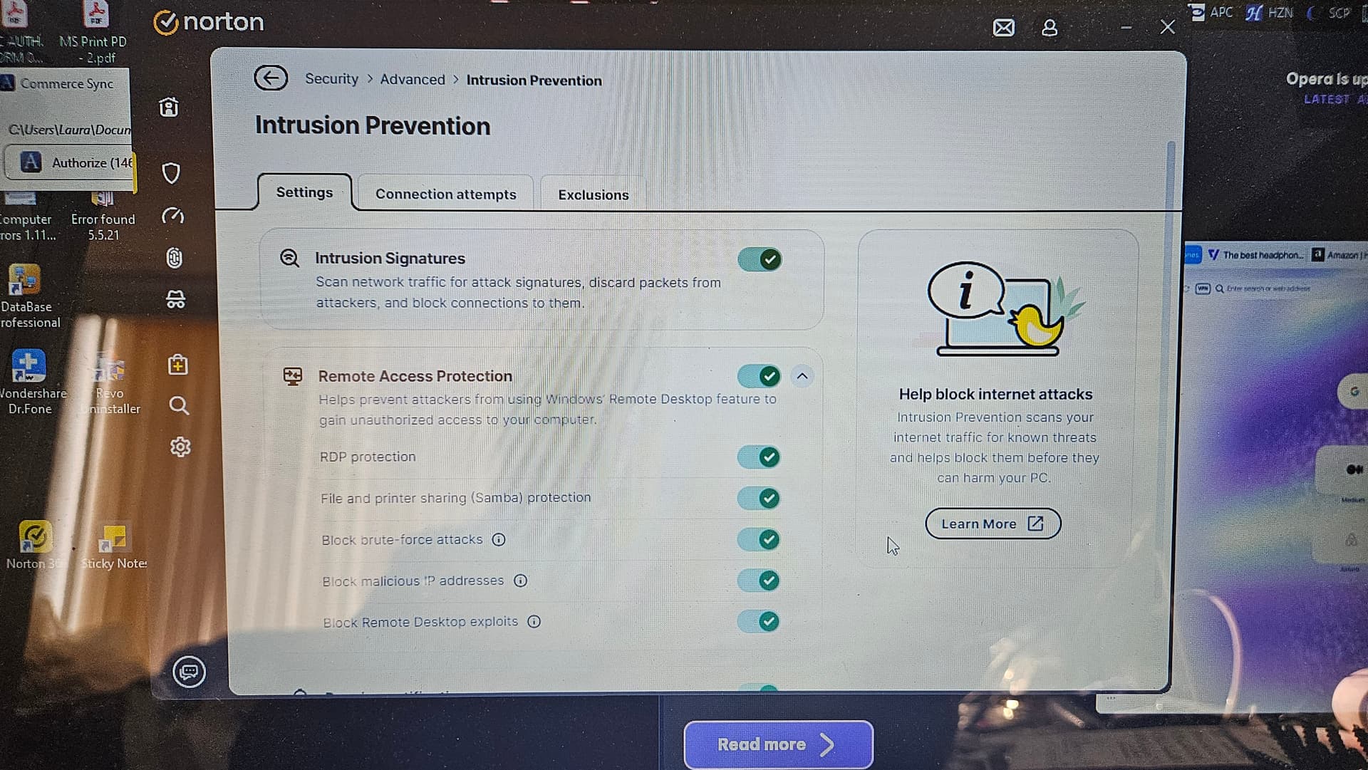

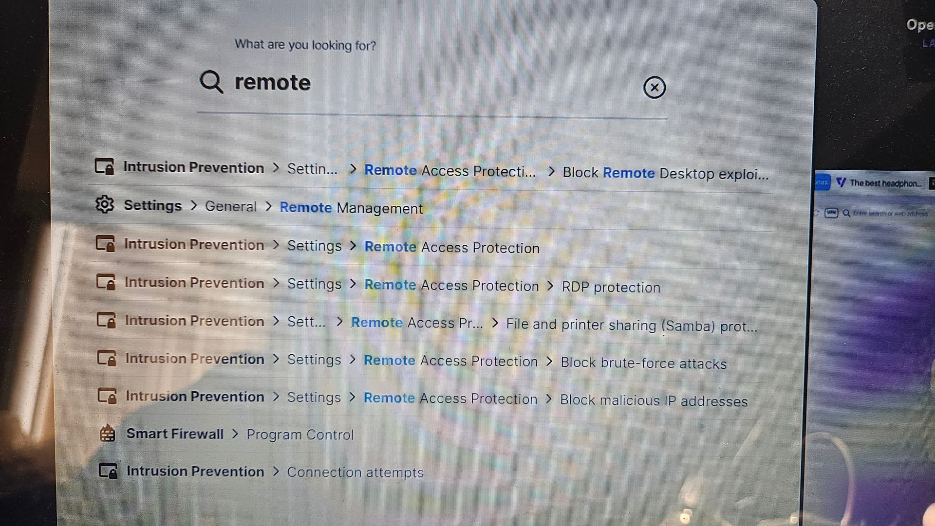

In the new version, I found that if you search for the word "remote”, the first thing that comes up is a menu under “intrusion prevention” >>Block Remote Desktop. When you click on that I didn’t know where to go from there, but I went straight to connection attempts and found that the IP address I have been trying to access this computer from remotely, was listed under the blocked IP addresses. It was the only IP address listed, so it was easy for me to find. I took a snapshot of it because Norton does not allow you to copy and paste the IP address and then I added it to the exclusions list. I restarted the computer but that didn’t work. As soon as I restarted a pop-up from Norton was there telling me that I was connected to a new network. I went to my other laptop which I was remotely connected via and still I cannot see the notification nor can I access the computer. If anyone has any recommendations as to what any of the settings in this menu or any other menu should be, it would be greatly appreciated!

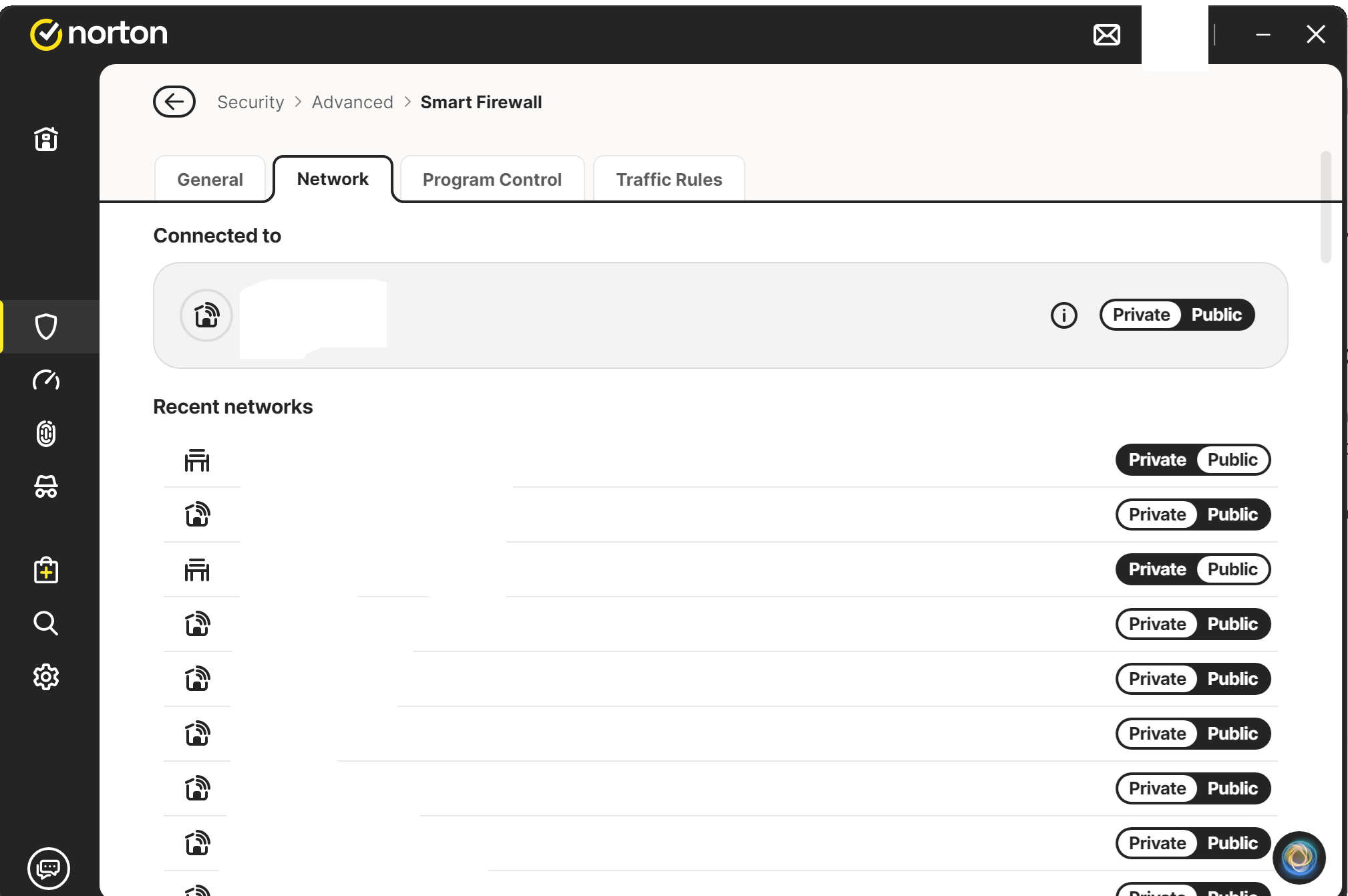

One thing I have found is that Norton 360 will sometime change the “status” of the wireless network from private to public. When it’s public, it enforces stricter access rules. For example, you won’t be able to ping the other computer. So if you are on your own private network and trust it, open Norton and go to Settings→Smart Firewall. Click on the Network tab, find your network name in the recent networks list and switch it from Public to Private. You should now be able to ping the machine and also take remote control of it. See below (I blanked out the network names).

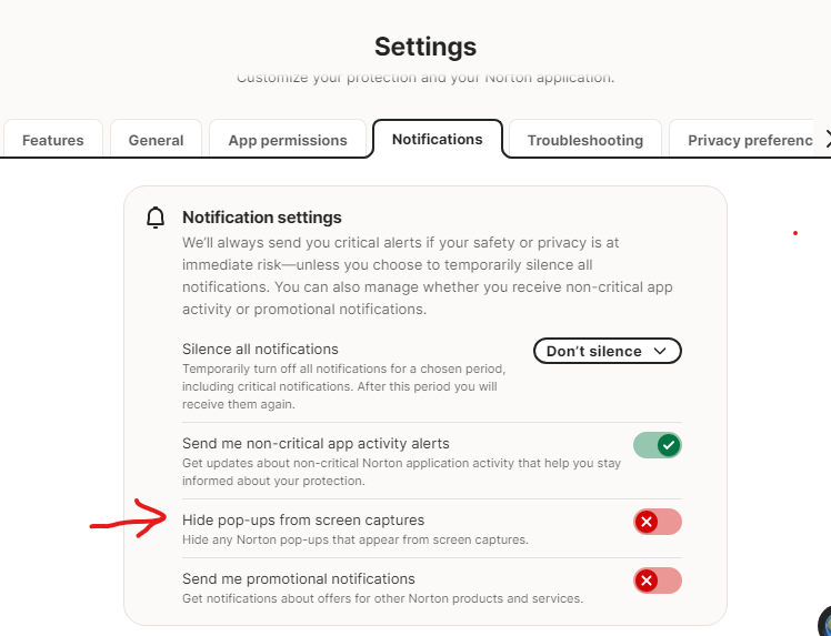

i found that when I disabled the “Hide Pop-ups from screen captures” in the notification settings I am able to see the Norton Popups again during my VNC connection
