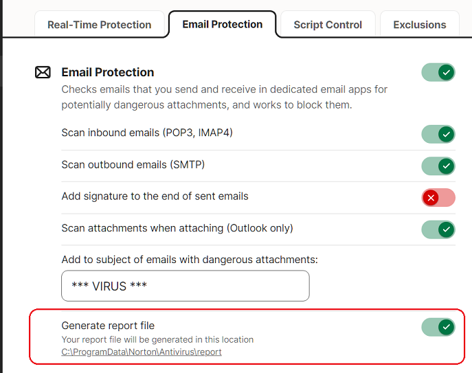

any clue with Security History > Resolved Security Risks | Quarantine

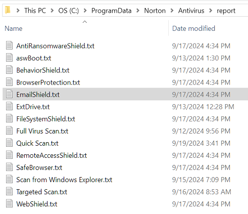

any clue with > C:\ProgramData\Norton\Antivirus\Report

  • I couldn’t find the C:\ProgramData\Norton\Antivirus\Report path anywhere in Explorer

Thanks for the continued interest in identifying the problem. I haven’t had any pop-ups since I changed the notification setting in Norton this morning, so I can’t attempt a screenshot. I have used your link to the report file to get this and see all the notifications since Sept 3rd, which is when this problem started. This is one which came in this afternoon and was recorded in the Report:
21/09/2024 14:31:08 Incoming email ‘Re:Your Membership has expired _ Extend for free’ From: Sam’sClub® abowgxotxkk@nfle.nbipzmtfqfllb.us, To: me@aol.com [L] HTML:ExtortMail-HG [Phish] (0)
File was successfully moved to quarantine…
You will see the time - this was 2 hours after I removed the Norton “Scan inbound emails” facility. I guess that I will need to totally shut down Norton and then re-open it for this removal to take effect. I will do that later.
PS: I can see from the report that I am getting around 25 dangerous emails a day out the over 100 I receive daily.
