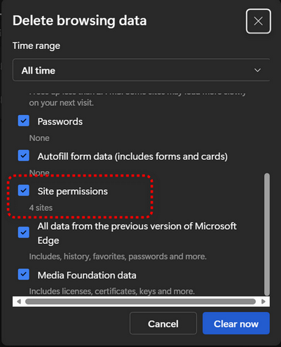

Try clearing browsing history:
  1. Open Edge.
  2. Click the 3 dots in the top right.
  3. Click “History”
  4. Click the 3 dots on the top of the “History” tab.
  5. Click “Clear Browsing Data”.
  6. Make sure the check box for " Site Permissions" is checked and that you enter the necessary “Time Range” in the drop down.
  7. Click “Clear Now”
  8. Done!

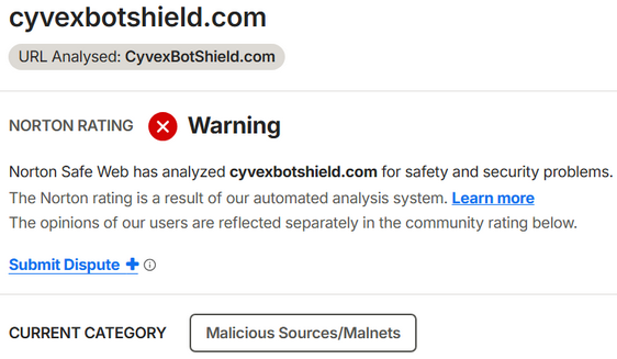

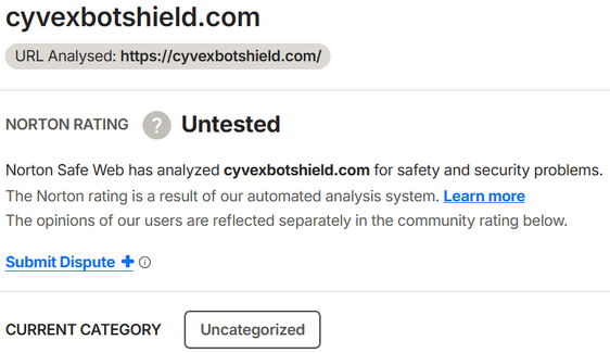

Malicious Sources/Malnets
Sites that host or distribute malware or whose purpose for existence is as part of a malicious network (malnet) or the malware ecosystem. Malware is defined as software that takes control of a computer, modifies computer settings, or collects or reports personal information without the permission of the end user. It also includes software that misrepresents itself by tricking users to download or install it or to enter personal information. This includes sites or software that perform drive-by downloads; browser hijackers; dialers; any program that modifies your browser homepage, bookmarks, or security settings; and keyloggers. It also includes any software that bundles malware (as defined above) as part of its offering. Information collected or reported is “personal” if it contains uniquely identifying data, such as email addresses, name, social security number, IP address, etc. A site is not classified as malware if the user is reasonably notified that the software will perform these actions (e.g., it alerts that it will send personal information, be installed, or that it will log keystrokes).
