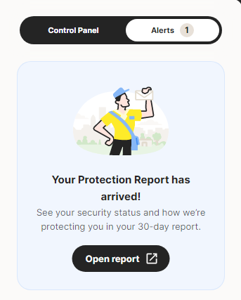

I have just received this notification Protection Report has arrived but the device security part does not load. I sat there for 1 hour waiting. I assume this is because I installed Norton 360 last week. But then again with all these issues with version 25 who knows?

This is the picture of the alert (that will not go away)

If I close this report and go back to Norton it is still there under “alerts” its very annoying that I cant (a) get it to work (b) ignore it.
Is this happening to anyone else? Will this thing stay here until I reach 1 month of usage?
Does anyone have a fix for this protection report?
Any insight would be helpful as I can’t get rid of the alert. NO matter how many times I open it and close the protection report.

I am getting this prompt which will not go away no matter how many times I view the incomplete report.
Can you confirm that the report won’t go away even after viewing it a million times?
Is this a bug? why wont the alert go away?

Yeah, Alerts seems to be hinky…at that this.
Alerts 1 … regardless how often I’ve → Open report

I can’t clear Alerts notice…too.
I can temporarily clear Alerts…then cycling user interface…returns Alerts 1.

Alerts 1…Protection Report → Open report …notice does not clear.

I can confirm this is now resolved in 25.2.9898 (build 25.2.9898.919)
The alert is now gone.
Mykola.
Yes, Alert is gone for me too.
