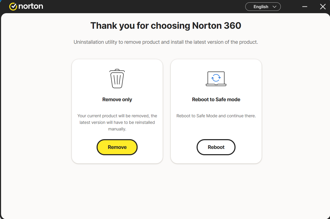

Download the Norton Remove and Reinstall tool here

fwiw ~ call NRnR tool against my Norton 360 v24.12.9725 (build 24.12.9725.902)
I see…
Had auto update to Norton 24.xx early October 2024 - full of errors. With-in GUI was a ‘Remove’ button, That opened something similar to bjm’s screen shot. Clicking on ‘Remove’ brought up NRnR app. which came up with error. Tried a manual remove with NRnR which also came up with same error. Had to remove thru’ Windows uninstall, downwloaded setup file from account, installed, all V24.xx errors gone. Apparently, there is a dedicated new removal tool which can be downloaded, have not tried that nor NRnR since. Assume with-in the address '" avcdn".net could be relevant.
https://honzik.avcdn.net/setup/norton-suite/release/norton_360_remover.exe

fwiw ~ call norton_360_remover against my Norton 360 v24.12.9725 (build 24.12.9725.902)

I think initially NRnR tool for v22 was not satisfying v24.
Norton offered Norton 360 Remover for v24.
Now, as far as I’m aware.
I think NRnR tool is satisfying v24.
Note: pick your preference
https://norton.com/nrnr
vs
https://www.norton.com/nortonremover
Note: Norton Remove and Reinstall tool does not uninstall Norton Family from your computer. If you have Norton Family installed, uninstall it before you run the Norton Remove and Reinstall tool. For instructions, read Uninstall Norton Family from your device.

fwiw ~ Chat support agent I spoke with does not know the difference or was unable to explain the difference regarding Norton Remove and Reinstall tool vs Norton Remover tool.
Chat support agent I spoke with stated Norton Remove and Reinstall tool is for v22 and Norton Remover tool is for v24.
  • Then where is Norton documentation pointing to Norton Remover tool.
