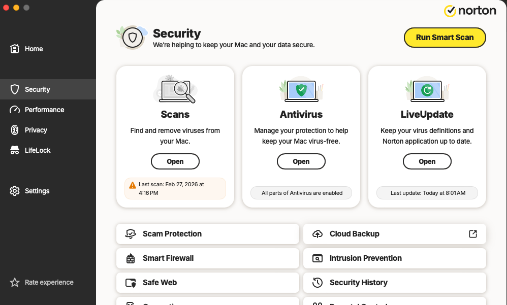

Detailed description: Original backup of files was from a Windows PC, have since moved to Mac and the filepaths are in a different format so I’m not able to just reconnect and re-access. The directions online indicate either downloading all the files individually or opening the Cloud Backup tile and restoring to a chosen filepath, but the former is unfeasible and the latter is something not apparently available in my version of the app. Cloud Backup does not appear as a tile along the top of the display, it’s a lower panel; when I click on it I’m directed to the backups themselves for direct individual download. There isn’t a way within that (direct download) interface to restore a full set to a given filepath on the new machine.

Norton Cloud Backup is exclusive to Windows, which is why the full-featured tile and the folder-structure recovery options are completely missing from your Mac application. Because the macOS version of Norton 360 does not contain the engine required to parse, recreate, or map Windows file paths (C:\User...) to Mac file paths (/Users/…), the Mac interface only provides a bare-bones web portal link to download individual files manually.
To download your entire backup set as structured folders without clicking every file individually, you must bypass the Mac client entirely.
