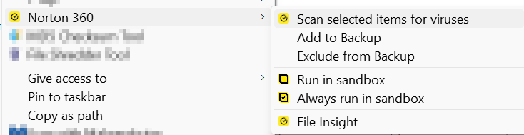

How do I scan a downloaded file in Windows 11? In Win 10 I would right click on the file and choose scan with Norton. I just tried that with the new install of Windows 11 and nothing happens. Norton does not scan it or react in any way.

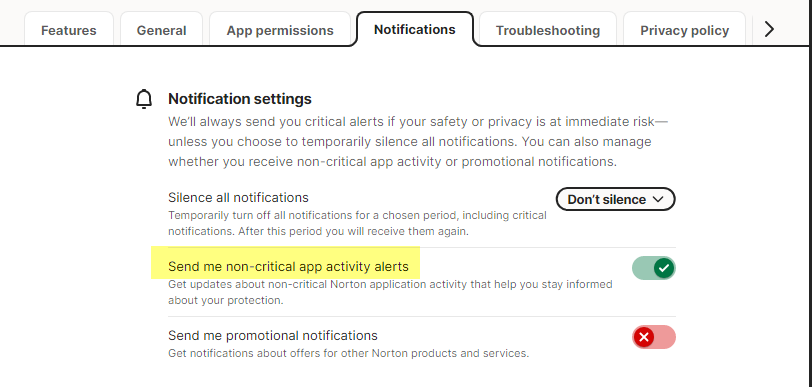

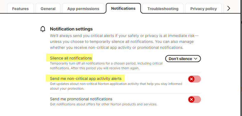

Please confirm you have not enabled Silence all notifications
Please confirm you have not disabled (red) Send me non-critical app activity alerts
Please confirm you’ve enabled (green) Send me non-critical app activity alerts
Silence all notifications needs to be disabled to see Explorer Scan
Send me non-critical app activity alerts needs to be enabled (green) to see Explorer Scan

Yes that is what I am saying, I have downloaded a .zip then I choose what you see “scan selected items for viruses”, but nothing happens. How do I fix that?
The notification disable both of them and it should fix it fix many thing like special offer so you dont get offer to norton utilities and more

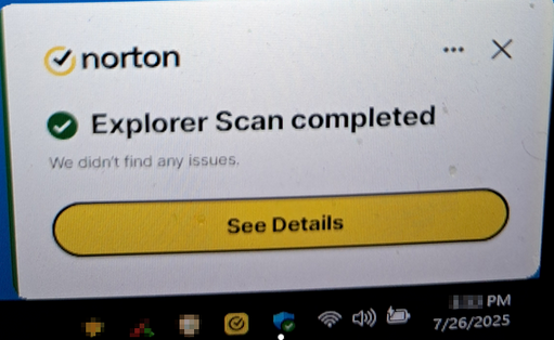

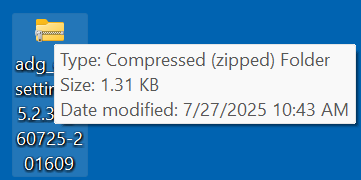

as test: zipped folder (.zip) Scan selected... reports Explorer Scan completed

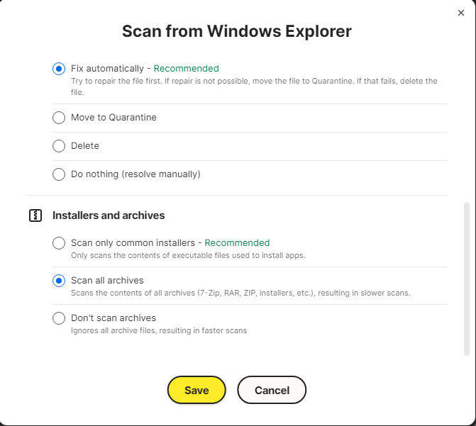

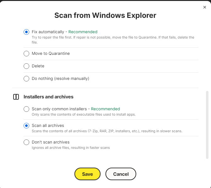

Please confirm Scan from Windows Explorer → Scan all archives is enabled
Caveat: my preferred setting is Scan all archives

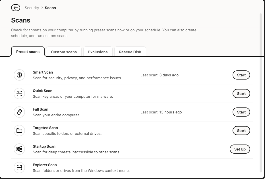

I don’t know how to Scan from Windows Explorer, I just switched to Windows 11 from Windows 10 and I am trying to figure out how to make things work properly. Can you tell me how to get to where I can select “scan all archives”?
Also I did try VirusTotal and it found 1 malware

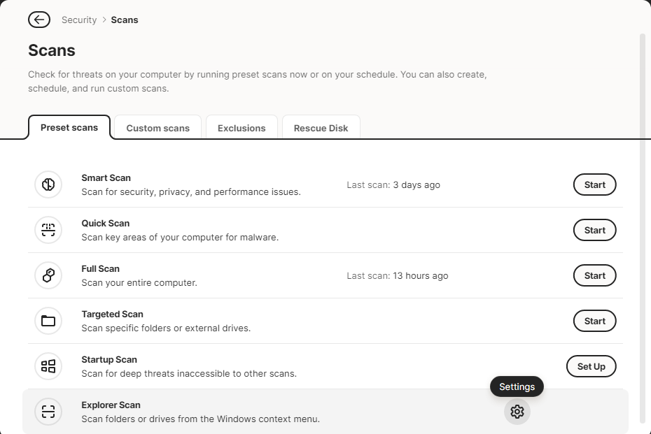

Scan all archives is Norton setting. Norton 360 → Settings → Scans
Explorer Scan → Settings
scroll down → Scan all archives → Save

The “scan all archives” was already selected. Just to be clear, I did unzip the file and Norton did nothing on the unzipped file.

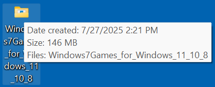

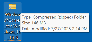

Is this the file:
https://win7games.com/
File: Windows7Games_for_Windows_11_10_8.zip
File size: 147 MB (153,842,646 bytes)
MD5 checksum: 792B397DE16EEE6DF930B6821D1F0209
SHA1 checksum: 804A28ACC805AAD118C5DE22D67ED6E7E820365E
SHA256 checksum: A491D9C78B1016BEAF3CE09265F64F3945C3F1D936414A2C2D73AE64C49E4743
Date/Time: 7/27/2025
VirusTotal report:
https://www.virustotal.com/gui/file-analysis/Nzky…Y0MDMyM
my Norton 360 → Scan selected... against that zipped folder reports Explorer Scan completed = No threats found
my Norton 360 → Scan selected…against the extracted file reports Explorer Scan completed = No threats found
