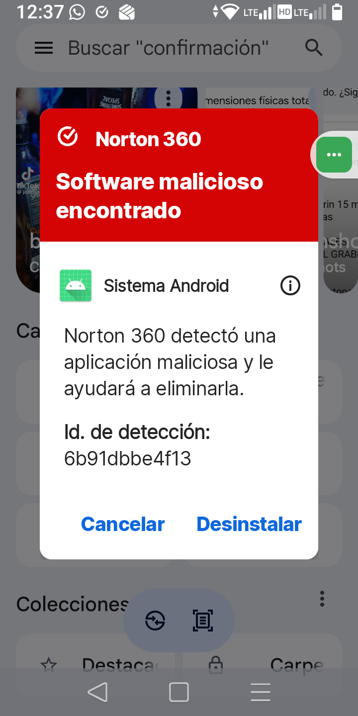

Detailed description: Tengo un problema en mi telefono movil con sistema Android, que a cada momneto detecta una aplicacion mailiosa pero solo me da la opcion de desinstalar, una vez que lo hago la vuelve a detectar y asi suscesivamente, cuando lo que realmente deberia es evitar que se instale, o bloquearle de alguna forma. Alguien tiene la solucion??

Telefono marca doogee modelo fire 3 pro, android version 15
Norton 360 version 26.10.1.260610581
Sistem Android is the name
Se instala sola por lo que el origen es desconocido, aunque en la informacion de la misma indica que es de la tienda de google play
Phone: Doogee Fire 3 Pro
Android: 15
Norton 360: 26.10.1.260610581
Detected app name: âSystem Androidâ (âSistema Androidâ)
It installs itself , and the source is unknown, although the app information says it is from Google Play .

thanks guru, but all done, and nothing resuts goods

Hello @Milton_Villacis
Norton is displaying a generic malware alert :
âSoftware malicioso encontradoâ (âMalicious software foundâ)
The app name shown is simply:
âSistema Androidâ (âAndroid Systemâ)
Norton offers only:
There is an information (âiâ) icon , which may provide additional details if tapped.
The detection ID is:
Whatâs not shownâand what we still needâis:
Threat name (Trojan? Heuristic? Riskware?)
Package name (e.g., com.android...)
Any explanation of why Norton considers it malicious.
My next question to the OP would be
Could you tap the â (information) icon and post what it says? Also, if you tap the app in Android Settings > Apps , what is the package name?
The â may reveal the detection name or other metadata.

Thank you for providing the screenshot. Since Norton continues to detect the application after uninstalling it, and the application appears to be system-related (âSistema Androidâ), I recommend contacting Norton Support. Please provide them with the screenshot and mention the detection ID (6b91dbbe4f13). They can review the detection in more detail and determine whether it is a legitimate detection, a device-specific issue, or a possible false positive requiring further investigation.
OP has provided enough to justify contacting Norton Support, even though there are still unanswered technical questions.
Hereâs what Norton Support now has to work with:
Device: Doogee Fire 3 Pro
Android: 15
Symptom: Norton repeatedly detects an app named âSistema Android.â
Behavior: The user uninstalls it, but Norton detects it again.
Evidence: A screenshot showing Norton identifying it as a malicious application and offering Uninstall .
Detection ID: 6b91dbbe4f13
Thatâs enough for support to begin investigating. They may ask for additional information (such as the package name or logs), but the case is sufficiently documented that it shouldnât remain solely in the Community.

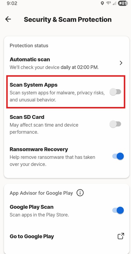

One other question coming to mind is has this device been ârootedâ at some point?
If you have Norton 360 set to scan system files, you risk getting the kind of warnings you are seeing here. That is because Norton detects a system app doing things that would seem to be malicious.
To disable the System App scan tap on the Account icon at the bottom right of the 360 interface. Then tap on Settings > Security then be sure to turn off Scan System Apps.
As long as you have not rooted the device, this will not reduce your protection.
