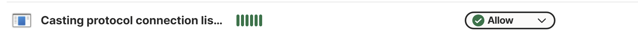

For me screen cast used to work, but some recent norton update has broken that W11 function. I have a Case # with norton, detailed the problem, uploaded a debug file, but so far no solution or even feedback is forthcoming. I will try to post a link to my thread in case any of my actions give you inspiration in your own efforts:
Well it looks like the link is to the latest post, but at least it is in the correct thread. Best of luck with a resolution!

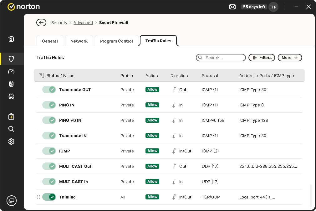

@Stephen_Mills View the screenshot below, then open your Norton UI to Security>Advanced>Smart Firewall>Program Control tab. Locate the entries there for Citrix and Thinlinc. Move your mouse slowly to the right past network access radio button until an V appears. Click it, find the “default rule” for each client separately and change / edit them to “allow”. Save and close the Norton UI, reboot and recheck.

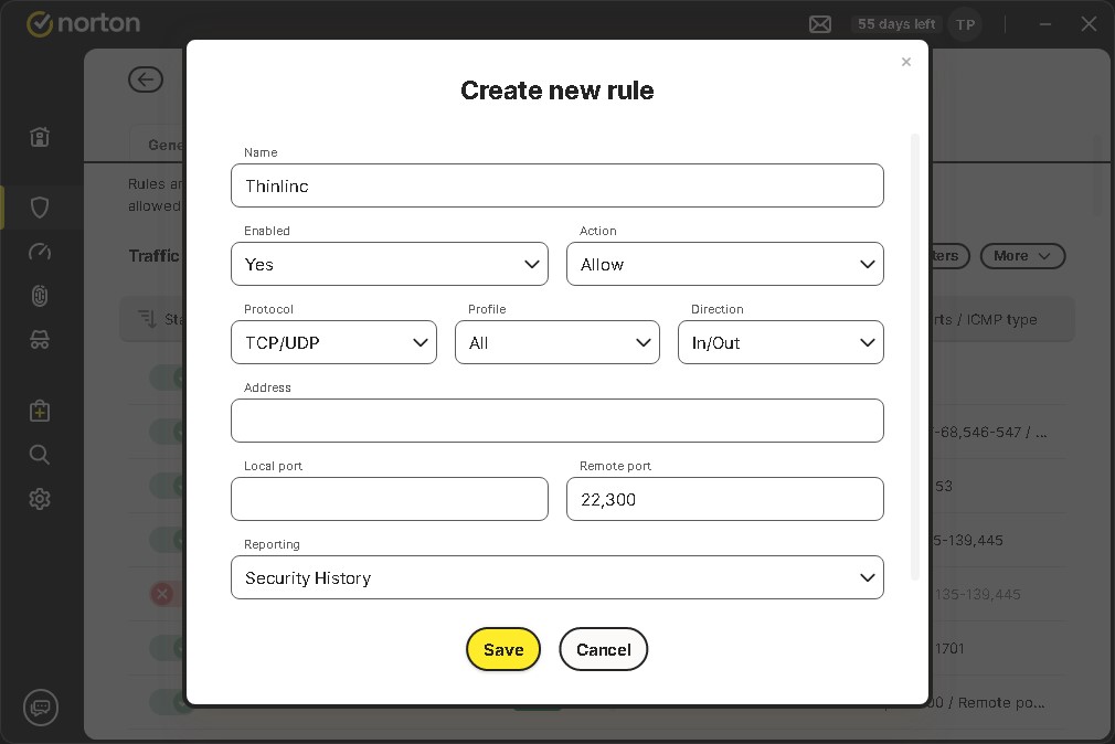

IMA that as @paul_murphy2 posted not a lot is changeable with the Firewall in the new versions. FWIW. Thinlinc requires port 22 server side, if I am not mistaken. Or, are you HTML5 and using port 300? Try creating a “new rule” similar to the one shown below. Add the address and local port. Reboot, retest.
SA, saw your great new rule suggestion here on the citrix thread, thought I would try that over in my circus. Unfortunately norton is blocking this as well. As soon as I hit Save the ports disappear, and then the Access button rolls to custom, and when Allow is selected the new rule has entirely disappeared. norton is not allowing me any changes.
@Stephen_Mills, I’m interested to know if you are able to have this new rule accepted in your case? I hope it works for you.

Edited: Leave the address field blank Paul, I did so and the rule stays.
