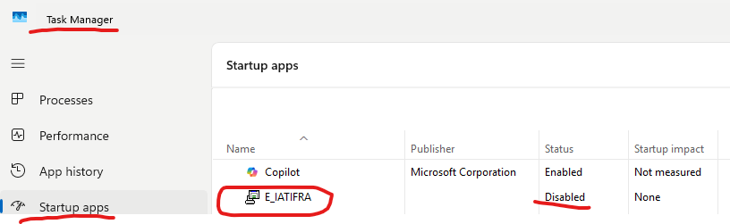

I found out that if you start TASK Manager
then go to startup apps,
then disable E_IATIFRA process.
this will stop the Norton and Mcafee popups
that are annoying
