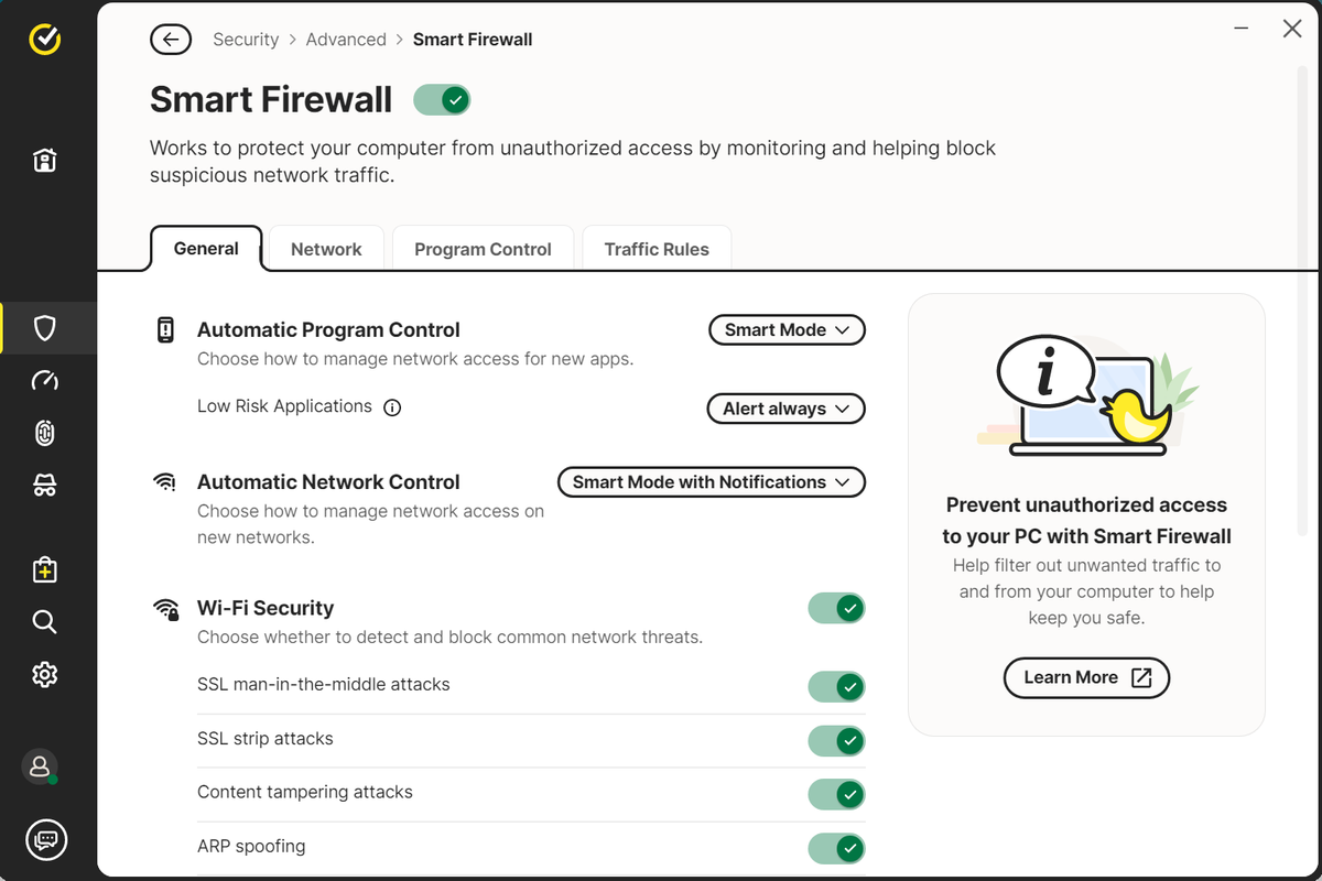

fwiw ~ here’s my Norton 360 v24 Settings > Smart Firewall >

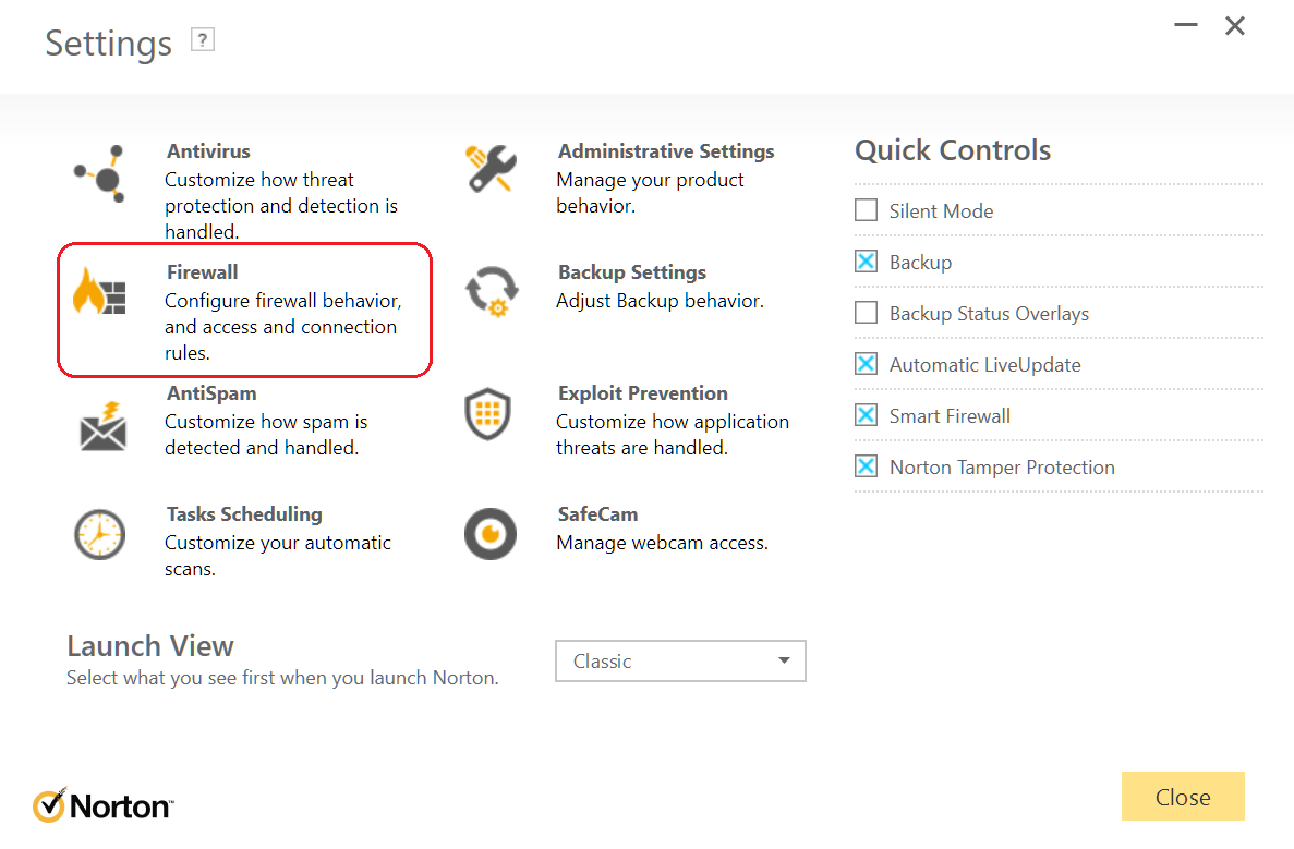

found v22 pics
I don’t know what version I have. There is no “about” option on the opening dialog. Perhaps on some sub-dialog, but one shouldn’t have to search through menus for the version. The 1st image posted by bjm on post #5 looks right. There is plenty of open real estate on this dialog, especially in the “My Norton” black panel at left. why not put the version right there? It’s amazing how many different steps I’ve found to get to the Firewall settings and that none of them actually worked for me. A version number shown somewhere might help that and would have cut down a number of posts on this topic. Anyway, back to my issue.
bjm’s 2nd image is not what I get when I click the Device Security Open button. Also, the drop-down menu on the Open button has nothing to do with what you get when you click it – another point of confusion. Here’s what I did to get to the Firewall settings:
