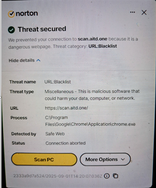

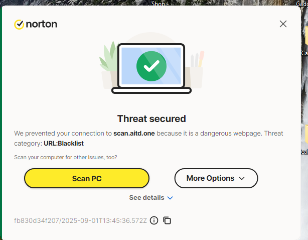

Starting last week, I started having a Norton pop-up come up everytime I started Chrome, and multiple times while using it!
Norton seems to identify this (scan.aitd.one) as a dangerous web page, but it’s VERY annoying that I can’t get rid of this message pop-up! My only ‘option’ is to “Report False Detection”, and I’ve tried that too, but it’s been over a week, and the message still pops up!
This may very well be a valid warning, but why can’t Norton either quietly block it, or honor the request to move it to a False Detection and thus not warn me EVERY TIME?
ps. I did run a complete scan of my PC, and after 2 days (network and USB drives take a lot of time to scan) it reported a couple minor things, but again, the message keeps popping up!
Hello @steve76063

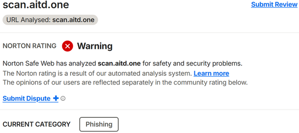

Did you submit False Positive report here with an Alert ID?
Do you agree or disagree with Norton 360 Safe Web?
Do you want to add an Exclusion if you disagree with Norton?
  • Did you clear browser cookies n’ cache?
  • Do you run browser sync?
  • Did you recently install program / browser extension?
  • Did you recently allow push notifications?
  • Did you recently change site permissions?
  • Did you reset browser?
  • Did you run Norton Full Scan?
  • Did you run Malwarebytes Scan?
2333a9d7a524/2025-09-01T14:20:07.036Z

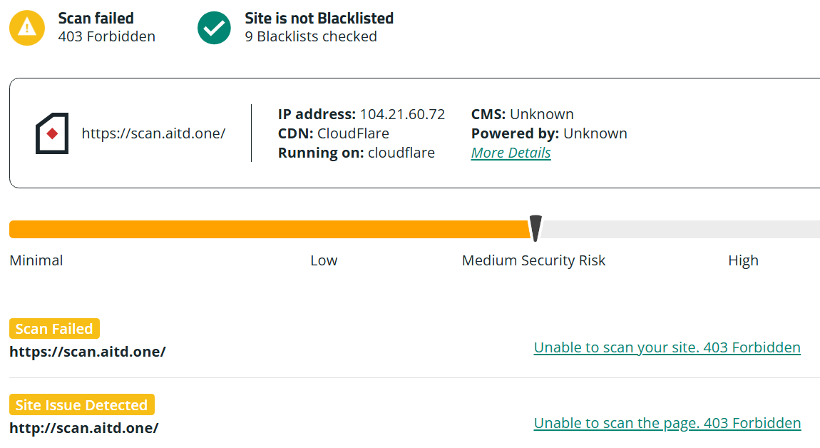

~ fwiw ~ as test: Norton 360 Safe Web = off

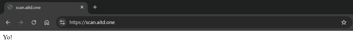

https://scan.aitd.one/
403 Forbidden
This error code may mean the site was disabled by its hosting provider because of malware problems. The site also may be under maintenance at the moment and you should try scanning it later. Another possible reason is some parts of the website have restricted access and our scanner could not scan them.

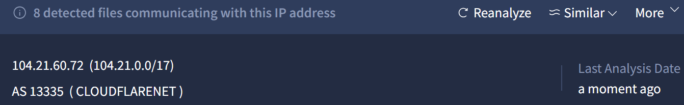

scan.aitd.one resolves to IP address 104.21.60.72
This IP address has been reported a total of 4 times from 3 distinct sources. 104.21.60.72 was first reported on May 4th 2022, and the most recent report was 4 months ago.
Old Reports: The most recent abuse report for this IP address is from 4 months ago. It is possible that this IP is no longer involved in abusive activities.

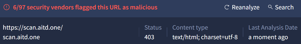

https://www.virustotal.com/gui/ip-address/104.21.60.72/relations

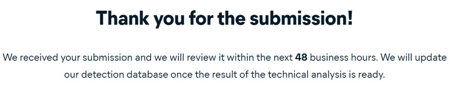

https://submissions.norton.com/submitsample#pc
Thanks for all the info…I did see that an ‘update’ to FreeVPN brought that URL into Chrome…I don’t use FreeVPN much if at all any more, so I’ve removed it from Chrome - we’ll see if that ‘fixes’ my issue.
I’ll read through the responses some more to try and figure out how it was found, and how I might turn up that information if/when it happens again!
