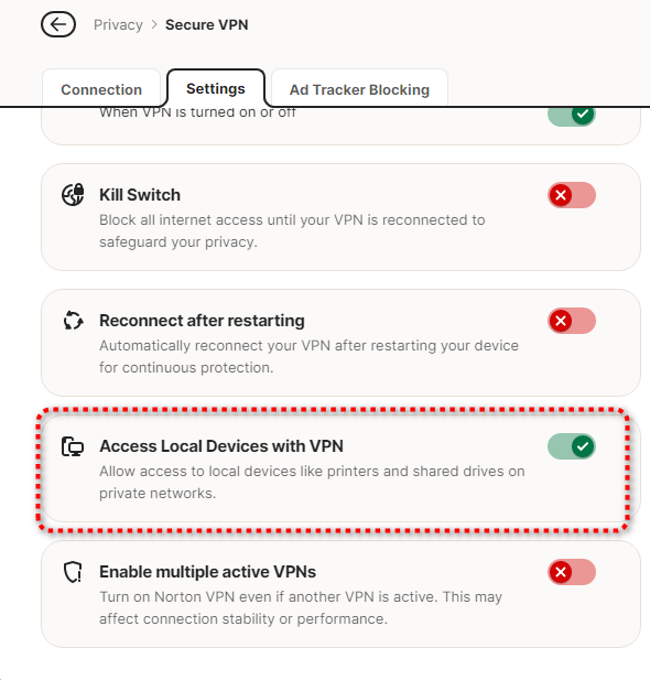

Option 1: Enable Local Device Access (Recommended)
Within the Norton 360 application’s VPN settings under the Privacy section, there is an option called “Access Local Devices with VPN”. Enabling this setting allows your computer to communicate with local devices, including your printer, while the VPN remains active.

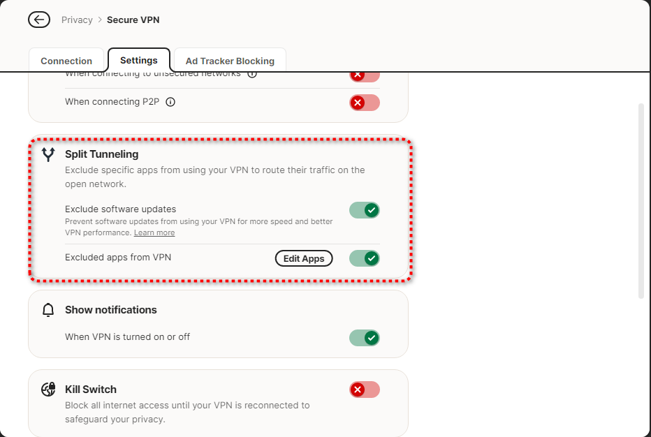

Option 2: Use Split Tunneling
Norton VPN offers a Split Tunnel feature that lets you choose which applications use the VPN and which bypass it. In the VPN settings, enable Split Tunnel and add your printer’s executable file (like HP Smart.exe) or the printer’s IP address to the exclusion list.

Thanks, bjm. I did not know about that but when I checked it is turned on.
Please try toggling switch off + Restart machine → then toggle switch on + Restart machine.
Then test…then if no joy.
Try Split Tunneling
