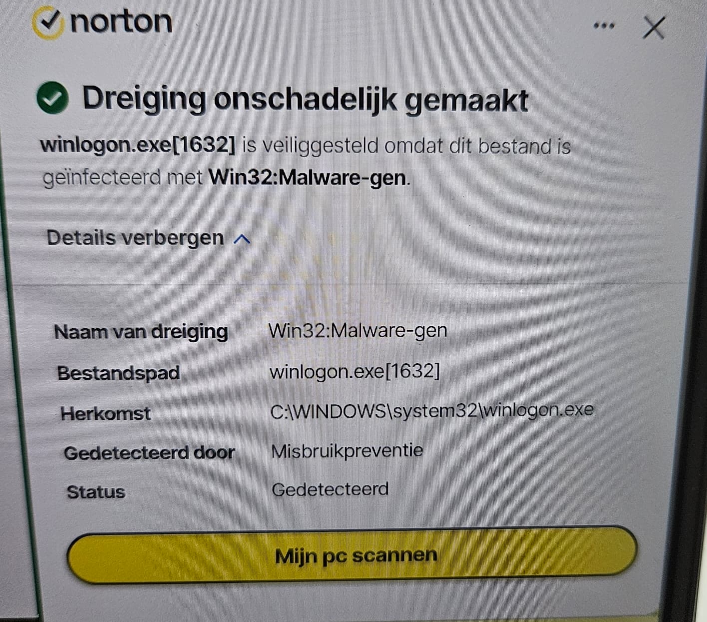

Detailed description: since a couple of months, i get the pop-up from the screenshot over and over again. The file is signed by MS. Scans of the system32 folder by Norton itself don’t bring anything up, as do scans by Windows defender, Malwarebytes and ESET. Also, submitting the file to Virustotal shows it as clean. The last scan of winlogon.exe there always shows up as recent, btw.
Product & version number: 360 25.10528.959
OS details: W11 25H2 26200.6899
What is the error message you are seeing? See screenshot

Gribouille342, bjm Thanks for your replies. The file is in the right location. Besides the copies (WinSxS) and mui versions windows itself keeps, there are no other present. Actually, since this has been going on for months I vaguely remember having it uploaded as a false positive already. Heard nothing back. Submitted it (again) just now. @BJM Atm, as you can see in the link I provided to Virustotal, you and I are on the same version of the file. I will look into the forum you mentioned.
Yes, I wanted to confirm your VT report.

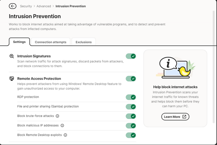

I’ll imagine …“Abuse prevention” is Exploit Prevention? or Intrusion Prevention?
Thanks
Learn more about Exploit Prevention here
Learn more about Intrusion Prevention here

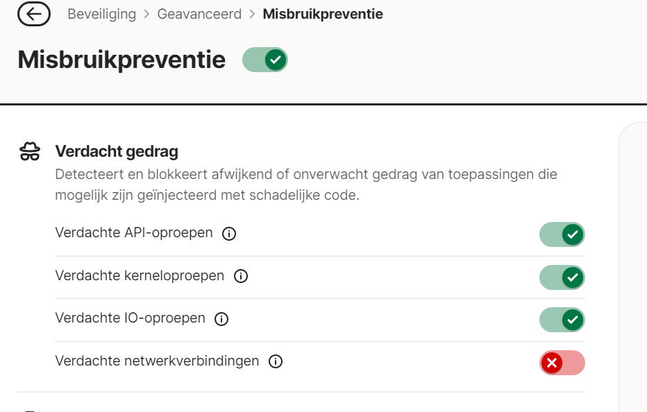

‘Misbruikpreventie’ must be the prevention mentioned under security - advanced - ….prevention. I am now trying to see what disabling one (after another) setting there will do …
There is never any discrepancy between the PID Norton comes up with in its alert and the PID of the winlogon.exe located in indeed system 32.

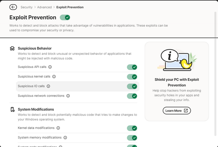

Well, thanks to you I learned Norton flags my valid winlogon.exe as doing suspicious kernel calls … Disabling this detection gets rid of the pop-up.
The only thing I can come up with as to the cause of detection is my Elan fingerprint driver which dates back to end of 21, would need an update.
Didn’t get any reaction on my recent, second false positive report from them. Perhaps that’s because There is no ID in the pop-up Norton requires in a false positive report.
Also remarkable that the detections don’t show up in the security history.
Any other thoughts than leaving suspicious kernel calls detection disabled?

Oh okay…Exploit Prevention…Suspicious kernel calls

Well, this few days later - not having seen the detection again - I think I can say it’s gone.
Though I’m happy after having been bugged for many months, I’m also not holding my breath. I have a hard time believing the slight bump in the fingerprint driver version did it. Or the update of the Norton app to 25.11 that came right after the driver update.
And who knows, without installing the driver and simply only moving the suspicious kernel calls slider back to on would have also done the trick.
