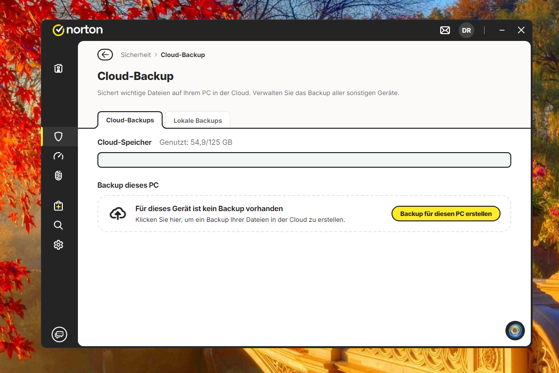

Issue abstract:
I cannot access or restore my existing Norton Cloud Backup on a new Windows 10 PC. The app only shows an option to create a new backup, even though my cloud storage is already used.
Detailed description:
My old SSD is damaged, but I had Cloud Backup enabled. My account shows 54.9 GB of 125 GB used, so my data should still be in the cloud.
Now I am on a new Windows 10 PC and installed Norton 360. In the Cloud Backup section, I only see the storage bar and the option to “Backup for this PC”. There is no restore option.
On the website (my-norton), I can see my backup, but I can only download files one by one, which is not useful for this amount of data.
I already checked all settings in the app but could not find any way to restore my backup from the Norton 360 Desktop app.
Product & version number:
Norton 360 Deluxe (latest version)
OS details:
Windows 10 (old and new PC)
No error message. The restore or download option is missing.
supporting screenshots (my version is in German):

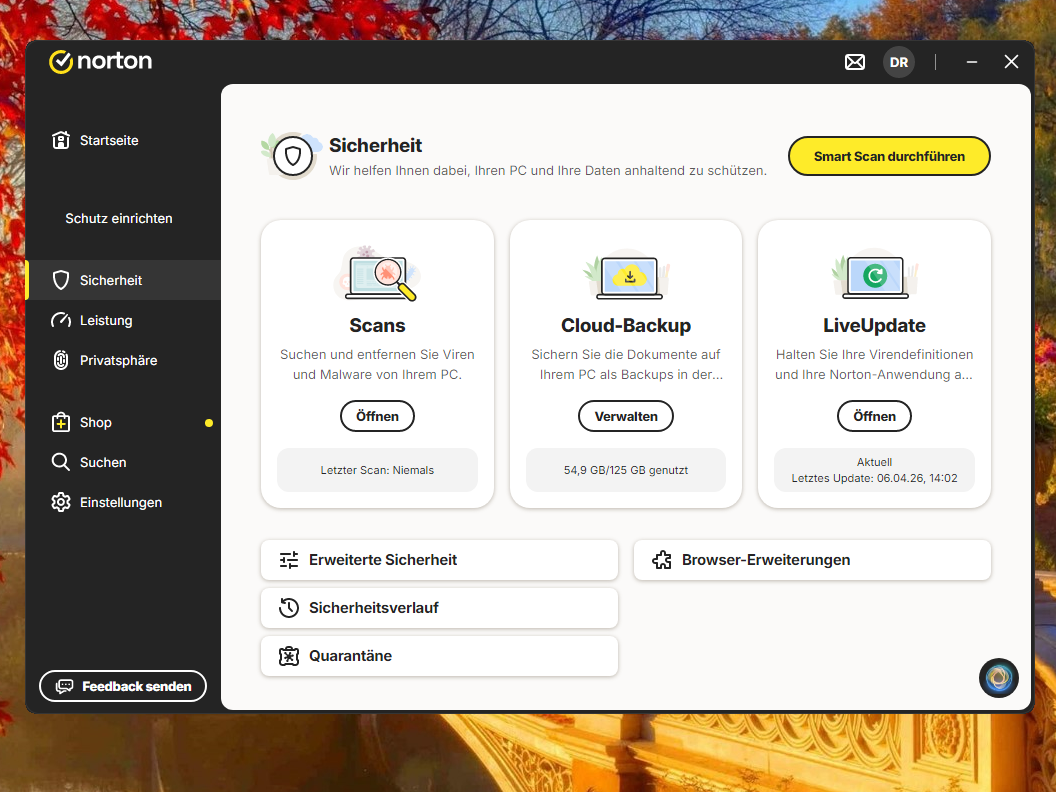

I will try post a few more screenshots for clarification (still German):
Here is the last one:

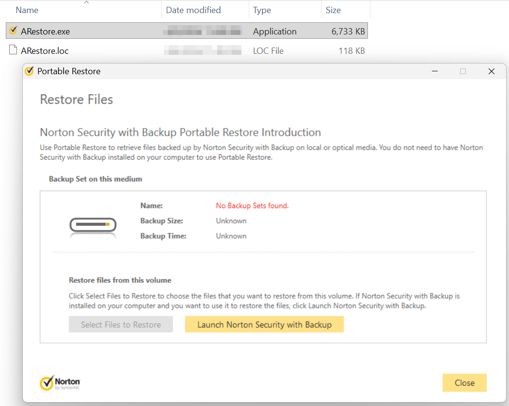

Did you try ARestore utility tool?
https://liveupdate.symantecliveupdate.com/upgrade/ARestore/ARestore.zip
To ensure the ARestore tool works correctly on your new computer, follow these formatting rules:

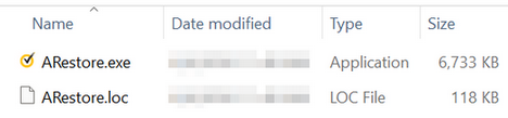

  • Extract Both Files: The ZIP contains two essential files: ARestore.exe and ARestore.loc. They must remain in the same folder together to run.
  • Administrator Rights: Right-click ARestore.exe and select Run as Administrator to give it permission to write files to your new drive.
  • Target Folder: When restoring, do not attempt to restore to “Original Location.” Instead, select a New Location (like a new folder on your Desktop) to avoid permission errors caused by different Windows usernames on your new PC.
If the tool still doesn’t see your backup sets, try signing out and back into your Norton account to refresh the cloud metadata.
Caveat: I’ve not tried ARestore tool long time
fwiw ~ as test:
as always, your mileage may vary
Thank you. Firstly not “cloud backup” but from a local NAS. I can use the ARestore.exe and that does work but i have noted it is only file based no folders.Also you don’t appear to be able to seach files. I’m almost at a point where one of the primary reasons for Nortons, which is for backups, is pretty horrible. I’m going to start looking at other backup products but it will mean that I will question the value of Nortons as a product, given I only use it for anti-virus for protection and for backups. I don’t use the other capabilities as I have better products for other services.
