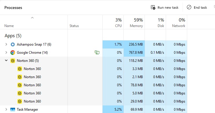

@Jonathan_Allenby Looking at your screenshot Chrome actually appears to be the memory hog being shown. Norton is actually taking about 300mb of system memory no CPU time. Have you ran live update on Norton recently before this issue began? Is your device running Windows 11 in S mode or does it have an ARM processor?

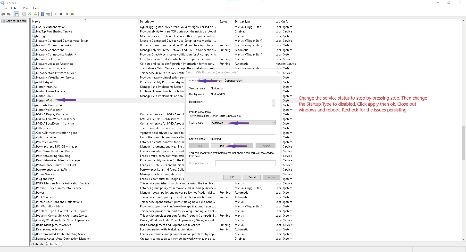

Having the VPN with Norton and NordVPN on the same system will cause issues. You should run one or the other, not both. If you want to use NordVPN disable the Norton VPN service in system services, set the start type to disabled. Reboot and recheck for changes. Highlight the VPN service and right mouse click to open properties. Make changes there.

So my system was locked up. When I launch the Task Manager, the Apps running display for a brief moment ā€˜Norton UI’, this then quickly changes to Norton 360 (5). Could this locking up be due to the UI not launching properly ? I’m not a professional, so I value your opinion and advice greatly.Thank you.

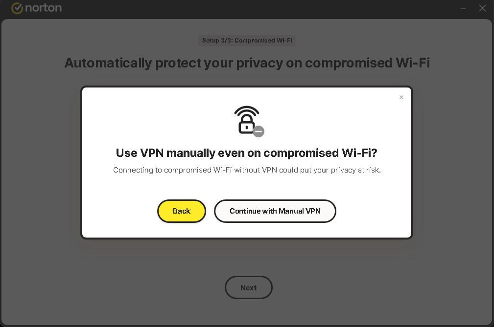

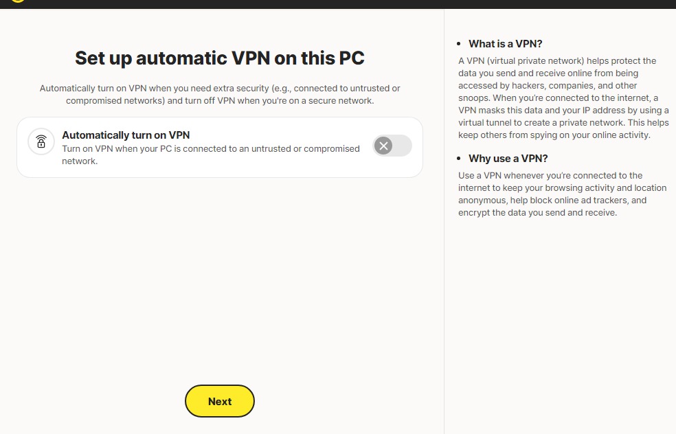

-Did you disable the Norton VPN service as suggested in my last post and restart? Recheck again? Whether you use or don’t use Norton’s VPN the services for it are installed by default. During setup I saw this, and used ā€œcontinue with manual vpnā€. There will not be further steps regarding the VPN after this is selected.

I have disabled Nrton VPN in Services. The system is still locked up.
With both NordVPN disabled at startup in Windows and Norton VPN disabled, and then re-installing Norton, my system is still locked up - this is despite me then going into services to again disable norton VPN.

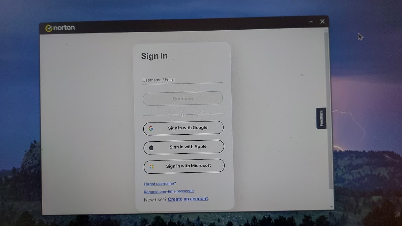

And further to all this, the Norton sign in screen pops up every few minutes but I cannot enter anything so Task Manager has to ā€˜End task’.

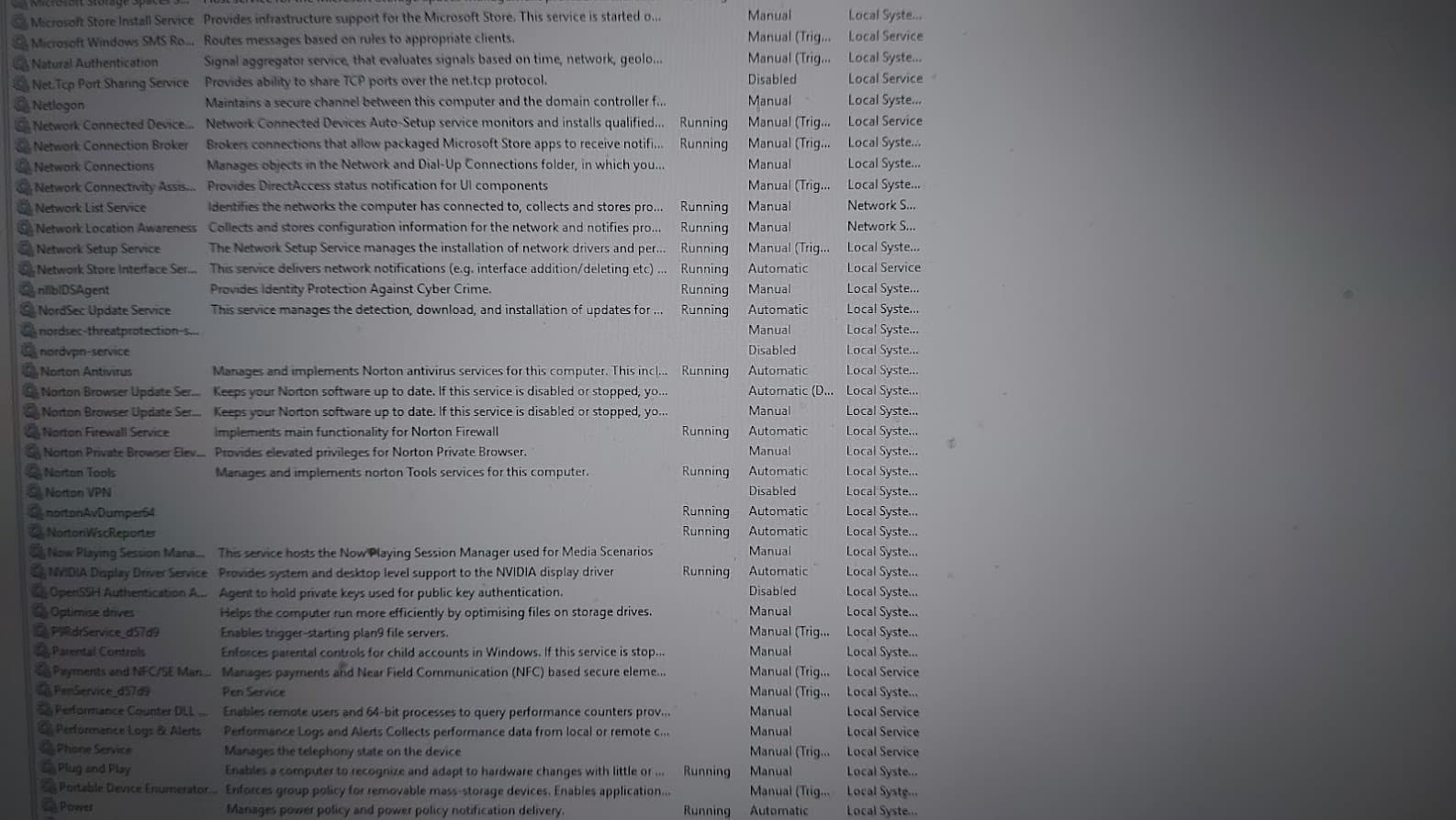

hi, I’ve disabled nortonvpn and also nordvpn. I shut down and boot up again. Straightaway, I get this screen and cannot click on anything to proceed.
then I check Services and:
and now I get the sign on screen pops again, so I have to use Task Manager to end the Norton tasks.

So on that login screen you cannot enter any information to log in, is that correct? Leave your system configuration as is and run the repair on your Norton installation again.
I cannot use the Norton control panel and this is also blocked so I cannot run the Repair tool unless there is another way to access it ?
