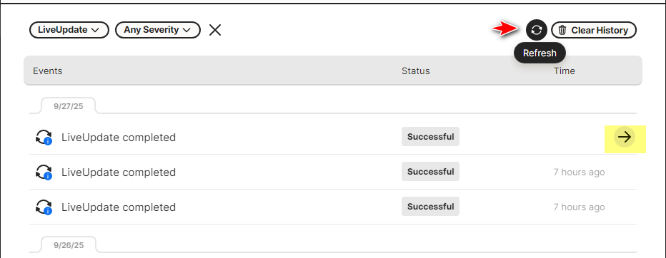

Have you reviewed LiveUpdate → Security History for ~24 hours to confirm?

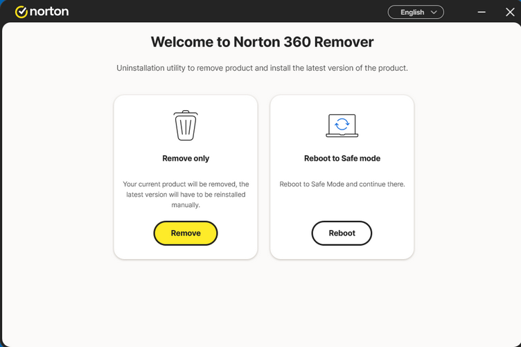

Maybe, you need to run Norton 360 Remover → Remove only…for clean uninstall → clean install.
Download and run the Norton 360 Remover tool for Windows here
fwiw ~ my preference is Remove only…with scour File Explorer for remnants and CCleaner - Registry - Scan for Issues + CCleaner…back up the registry before making changes. Just me.

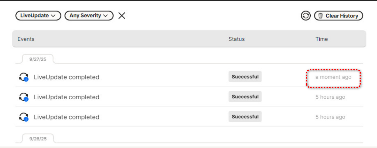

Did you Refresh → Security History?
Note: a moment ago
is three hours ago…before Refresh

Maybe, I’ve reproduced your scenario.
May be best to report/document your scenario via Norton support.
as test: LiveUpdate = off … 5 hours ago

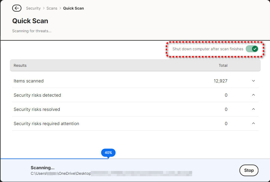

Shut down after a Quick Scan or Full Scan?
I’ve not tried Shut down computer after scan finishes.
I’ll try Shut down computer after scan finishes…enabled.

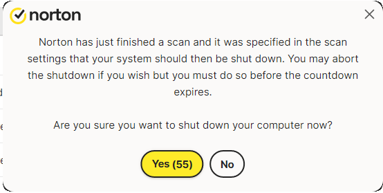

Edit: countdown expires → my machine shut down
Caveat: Administrator user account…Fast Startup disabled

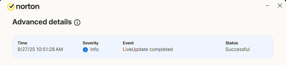

Has LiveUpdate stopped updating automatically or are you reporting that LiveUpdate continues to run with LiveUpdate off?
When you view Check for updates…you’re seeing date/time stamp that suggests LiveUpdate did run with LiveUpdate off or you’re seeing date/time stamp that suggests LiveUpdate did not run with LiveUpdate off.
for example:
If you’re reporting LiveUpdate continues to run with LiveUpdate off. I’ll try to reproduce my side.
