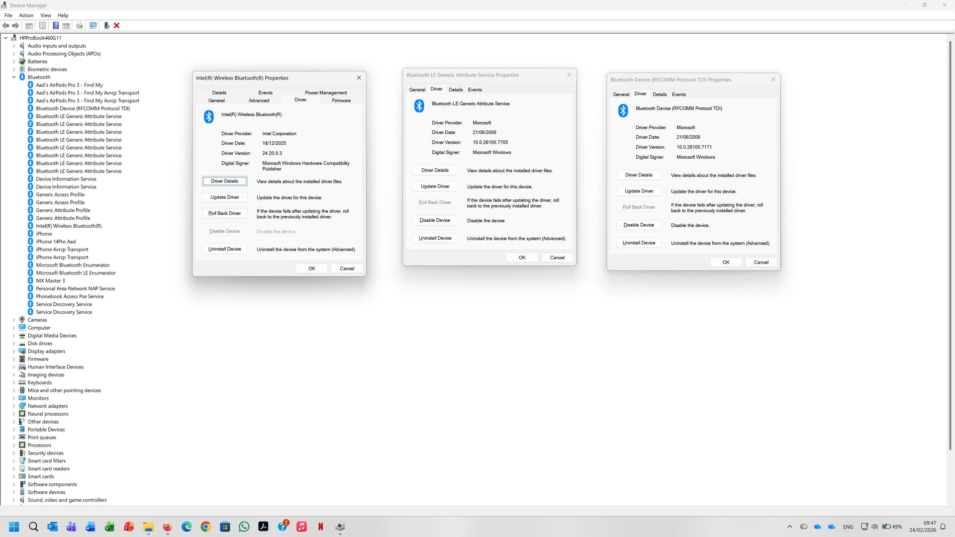

Please see attached screenshot. Since I reported the issue the Bluetooth driver has been updated and the issue no longer arises. But at the time it showed the same Intel version despite multiple rescans . If it is a timing issue then there must be a difference between the original scan at app start up, a rescan, and how device manager does it.
In the meantime I have also updated the Driver Updater app to the latest release (v26.3 build 6444).
