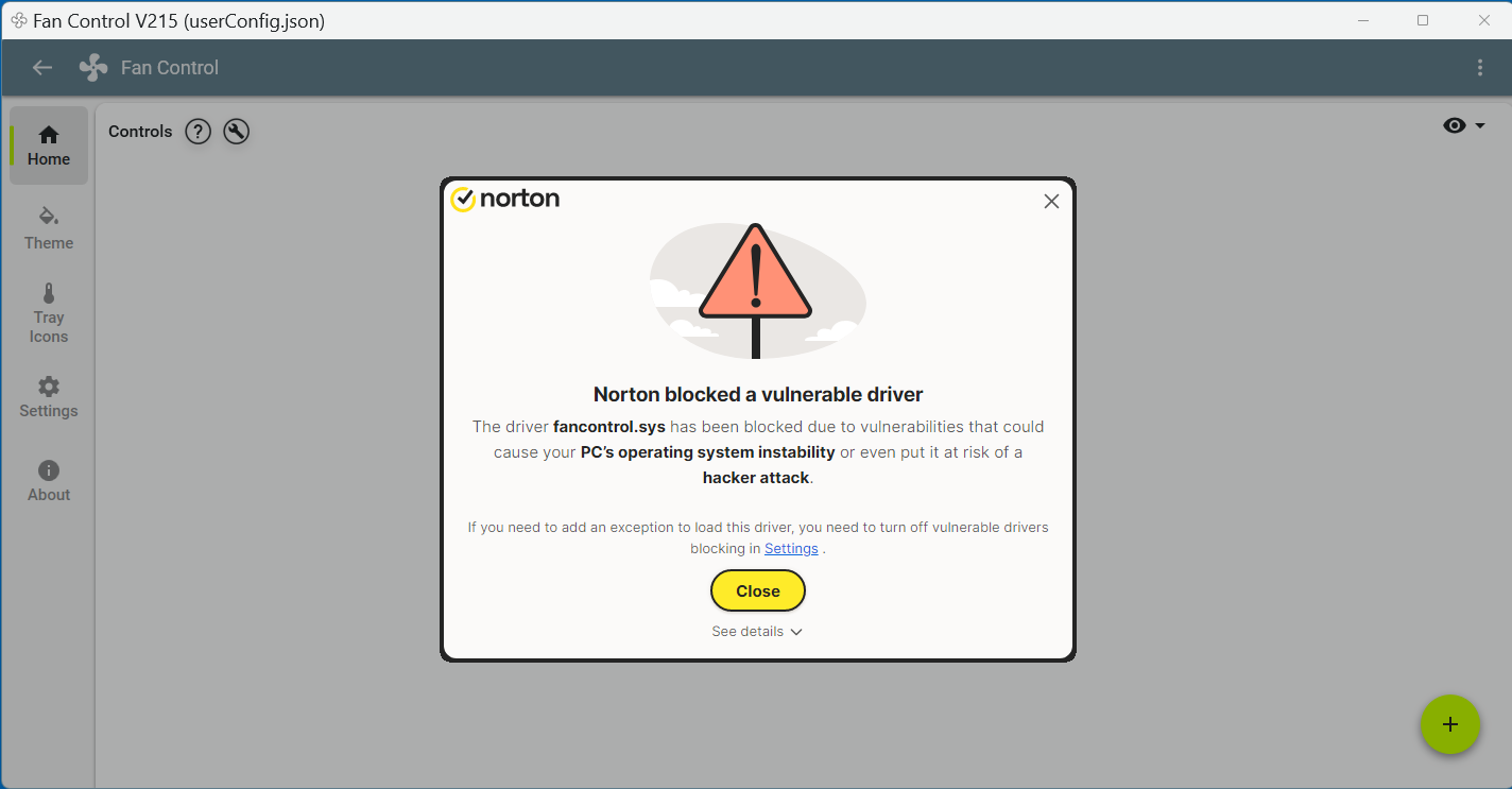

further testing - Norton still objects to FanControl installer loading FanControl.sys.
  1. allowing FanControl app permissions did not satisfy Norton.
  2. adding FanControl installer to Antivirus & Scans exclusions did not satisfy Norton.
  3. adding FanControl installed folder to Antivirus & Scans exclusions did not satisfy Norton.
Norton blocked a vulnerable driver
The driver fancontrol.sys has been blocked due to vulnerabilities that could cause your PC’s operating system instability or even put it at risk of a hacker attack.
Maybe, FanControl files need to be signed.
Maybe, fan control is too risky.

  • added Antivirus & Scans exclusions for FanControl installer and FanControl installed folder
  • added App permissions for FanControl
Norton remains:
I even tried to set those exclusions explicitly for the fancontrol.sys file, but that doesn’t help as well. Seriously getting more and more disappointed that there is no “Run anyway” like button that even Defender has.
Interesting workaround is to turn off “Block vulnerable kernel drivers”, launch FanControl (and do any setting necessary) and then turn “Block vulnerable kernel drivers” on again. This way the fancontrol.sys is already loaded and the app works as expected - up until some change in config is needed, then it re-loads the fancontrol.sys and Norton catches it again.
@bjm Do you perhaps have some way to raise it this issue to Norton dev team? To me this seems like a bug of some sort that these exclusion rules do not work.

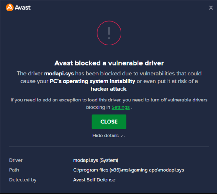

  • avast blocking controlcenter vulnerable drivers here
  • AVAST antivirus detects FanControl as virus #1521 here
  • Apparently fan control has unpatchable vulnerably kernel driver here
  • Avast detects the driver as vulnerable #1908 here

Okay…based upon my read…Norton follows Avast here & here

All switches disabled in Norton (no protection active) and still, its blocking fancontrol.sys
