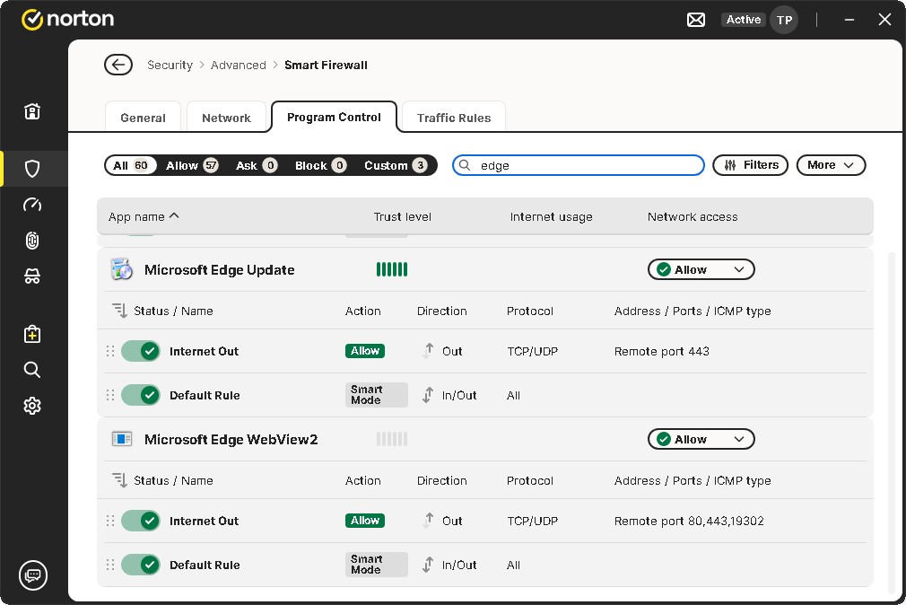

I DON’T use Edge as my daily use browser but do from time to time. FWIW. When using the MSN Windows app to view news there are times when an ad that begins get dumped by Edge WebView Access. Nothing shows in my history that that takes place. Here are my default rules as set when installing Norton, I have not edited them to date:
Hi SA,
and thanks for your reply. Yes, my firewall rule looks the same. Nevertheless, I just had the same problem with MS Edge again. :frowning: Deleting and manually re-installing it and it works - temporarly…
