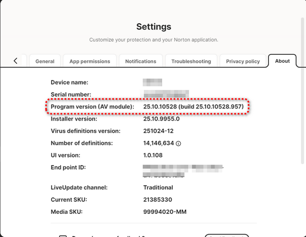

Product & version number:Norton 360 standard. I can’t find a version number but I regularly check to see if there are updates and always install them.
OS details: Windows 11 Home

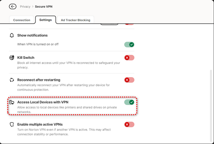

Did you try Access Local Devices with VPN enabled?
When you have Norton 360’s VPN active, your printer may appear offline because the VPN creates a secure “tunnel” for your internet traffic, which can prevent communication with other devices on your local network, like a wireless printer. To fix this, you need to adjust your Norton VPN and computer settings.
Solution 1: Enable access to local network devices in Norton
This is the most common and easiest fix, as it allows your PC to communicate with devices on your local network while the VPN is still active.
  1. Open the Norton 360 application.
  2. Click on the Privacy section, then select Open within the VPN area.
  3. Go to the Settings tab.
  4. Find the option called “Access Local Devices with VPN” and turn it on.

I have tried everything you suggested in your post, based on an earlier thread, except using split tunneling. The first one,Access Local Devices with VPN, had always been checked. Nonetheless, I turned it off and on again, with rebooting, a while back. It made no difference.I also have always had it set as a private network.

I found my version number. It:s 25.9.10453 (build 25.9.10453.954) Live Update says I’m up to date.
