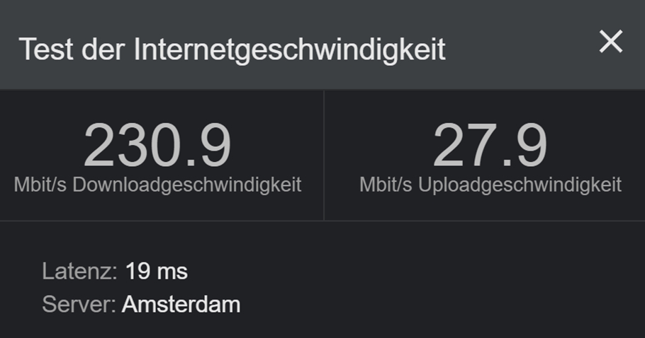

Today I removed the 24 Version, restart and install the old 22.xx Version.
Speed with 24.xx
With the old 22.xx
