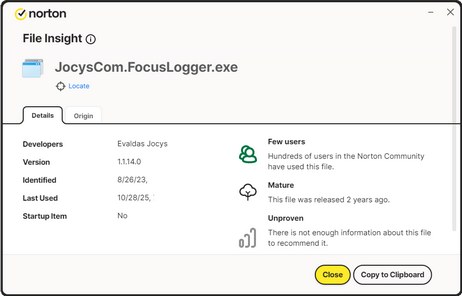

https://github.com/JocysCom/FocusLogger
Developers: Evaldas Jocys
Version: 1.1.14.0
Identified: 8/26/23,
Last Used: 10/28/25,
Startup Item: No
Few users
Hundreds of users in the Norton Community have used this file.
Mature
This file was released 2 years ago.
Unproven
There is not enough information about this file to recommend it.
Origin
Downloaded from: https://release-assets.githubusercontent.com/github-production-release-asset/408222493/b381dbb5-9860-478a-8ef1-7e35f47980df
File: JocysCom.FocusLogger.exe
File size: 489 KB (500,672 bytes)
MD5 checksum: 6F7685EE4E13E3640D28A5D4B145C386
SHA1 checksum: 71C46372C151C8979CD13D3E0B0003C09E8FFA5F
Date/Time: 10/28/2025
