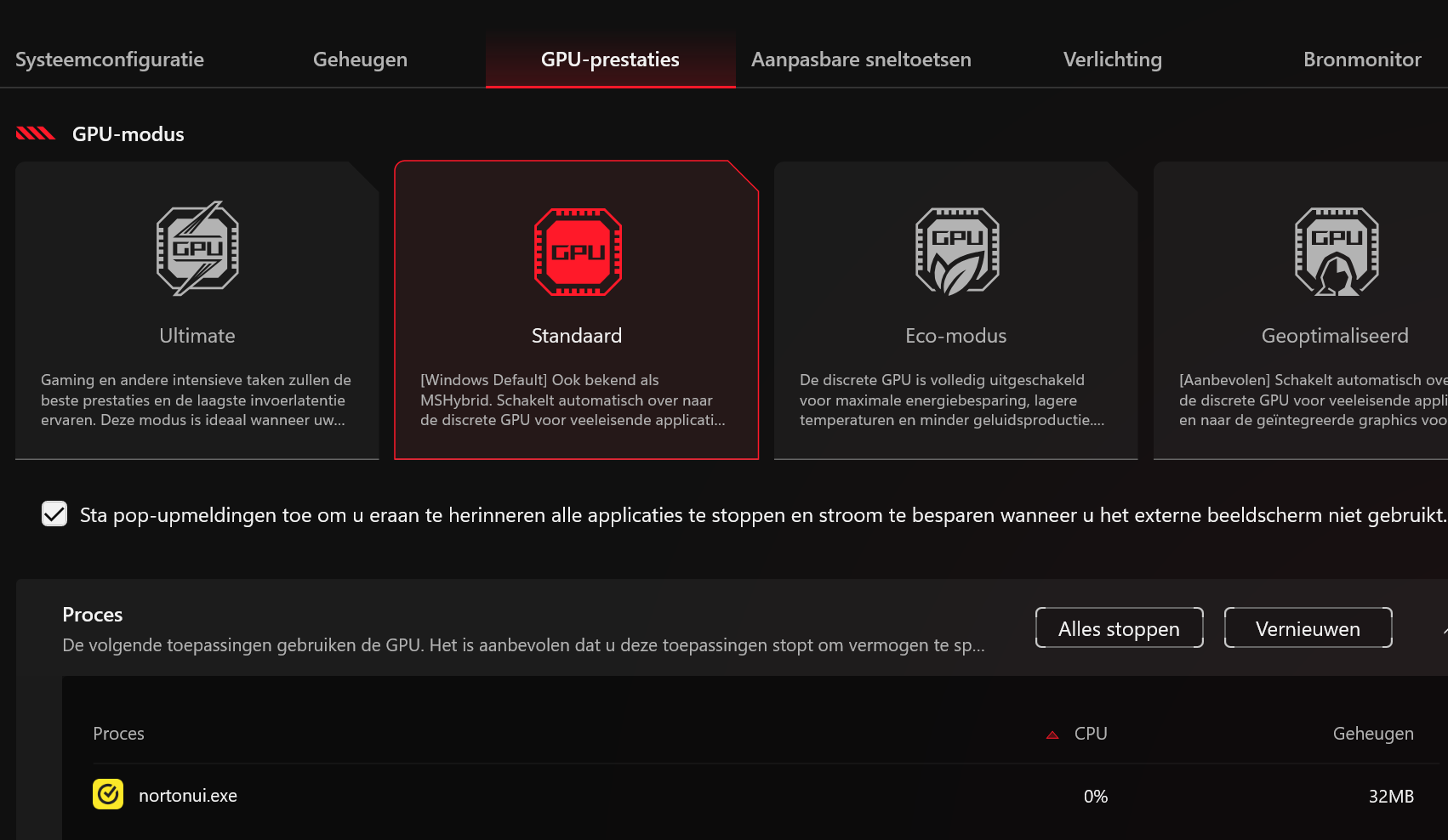

The only thing that forces it to use the IGPU is to reboot in eco-mode, but as soon as i swap to standard or optimised it detects the DGPU and forces it to stay on by running nortonui.exe. Turning off the deepfake protection didnt change anything (it barely uses any resources)

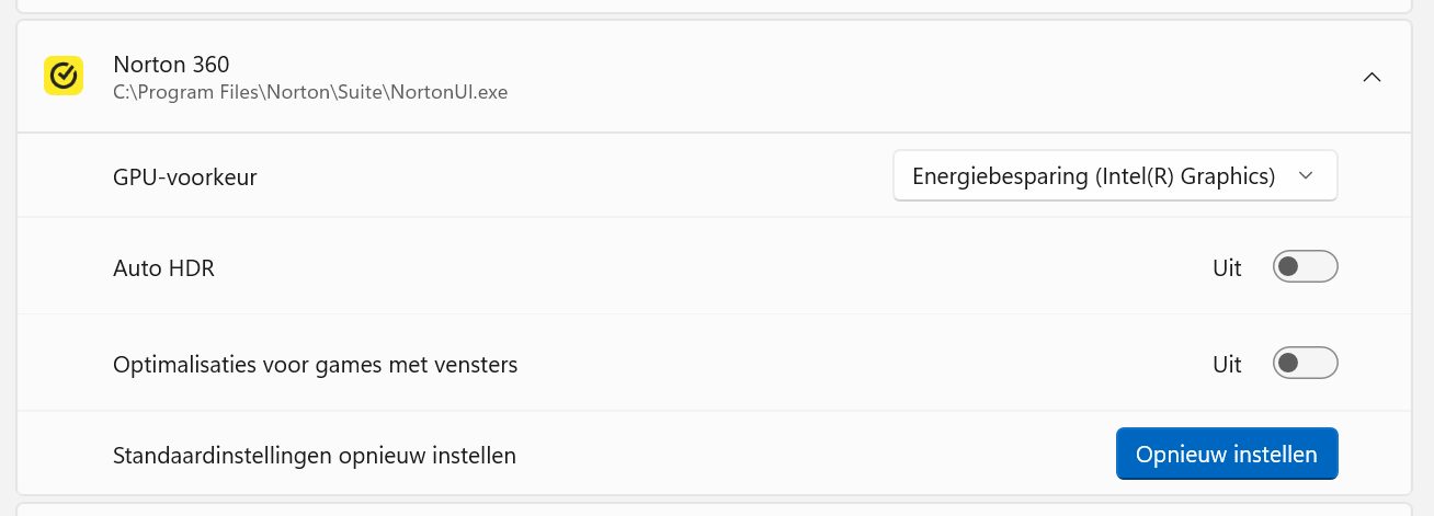

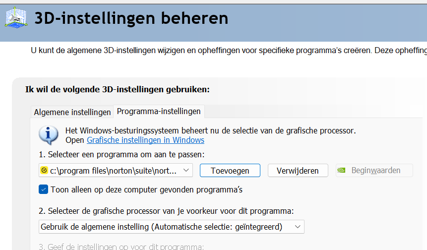

Just to add, i forced Norton both in my NVIDIA driver (the first screenshot) and in Windows (the second screenshot) to use the Intel GPU. It still runs on the NVIDIA.
NVIDIA settings
Windows settings
I tried using Copilot to fix this, and according to that the problem is that NortonUI uses WebView2 + Chromium, and that makes my Asus-notebook think that its a GPU app thus loading it on the DGPU, overruling Windows and NVIDIA settings. Due to security, its unable to close it once it starts, thats why the only fix is to fully restart the pc in eco-mode and never booting the DGPU in the first place. Even if i start in eco, as soon as i switch to standard or optimized, the dgpu boots up and Norton is loaded there.

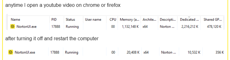

Update on my issue. I had disabled the scanning of Deepfakes and the problem went away. Today, I had a Windows update after the reboot the problem returned. However, now this is not deepfakes, the only way to prevent the issue was to shut of antivirus. As before, any video I play from youtube is choppy, the responsiveness of my mouse is very bad and the GPU usage by Norton hits 100%. The only way that I seem to be able to run is to disable antivirus.

A sort-of fix for now is to just reboot it in eco-mode, and only switch to standard/balanced when you need performance. As long as the dgpu isnt started NortonUI.exe wont run on it. The only downside is that you have to restart all the time when you want the laptop to run cool/have decent battery life.
