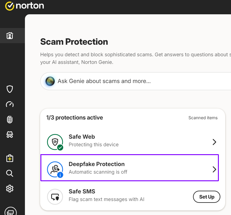

Hi All
Something that might be related here is the DeepFake Protection feature. Try clicking on Scam Protection from the main 360 user interface and turning off DeepFake Protection and test.

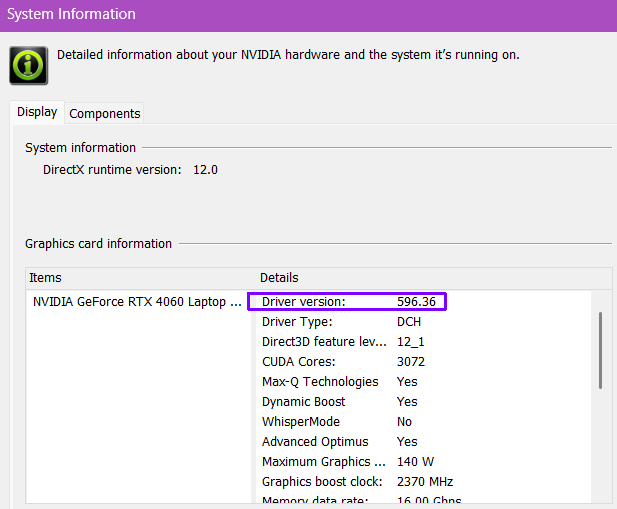

I have a later version of the driver shown here:
Since I did that driver upgrade (mentioned in previous post), things have been much better in regards to lack of video hardware crashes. I was overdue for that driver upgrade and glad I did it.

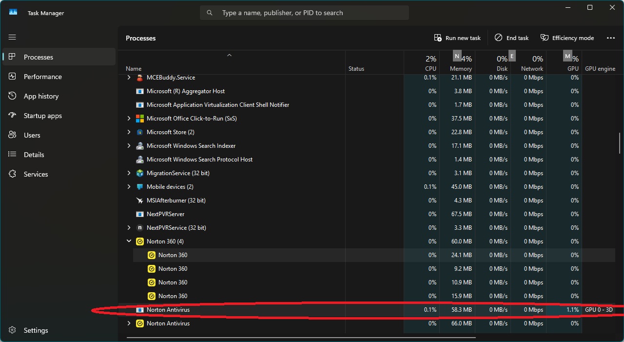

I was also seeing GPU usage by Norton 360 (nortonui.exe), even after disabling deepfake protection. It was using between 1 to 2% of the GPU as soon as Edge was opened to my home page. It would drop to zero when the browser was minimized or closed. I believe this started occurring after a program update around May 5, 2026.
After Norton was updated to v26.5.10994 yesterday, GPU usage by Norton 360 is still 1 to 2% when Edge is active. But now the process that is using the GPU is Norton Antivirus (model_host.exe). What is weird is that it seems to be a “rogue” process that is not grouped with the other Norton Antivirus processes.
Although the usage is low, it is enough that it raises temperatures of the GPU by 1 to 2 degrees which causes the fans to kick in. I would like it to stop.

The file “model_host.exe” is located in “C:\Program Files\Norton\Suite”.
I’m not sure I follow your reasoning behind Next PVR possibly being part of the trigger. Why would you zero in on that process specifically as something that could be causing Norton’s GPU usage when Edge is active given all the other processes that are running?
As I have stated before the “model_host.exe” file is not present in my installs as of this posting. Your screenshot shows 1.1% GPU usage by a Norton process, that alone isn’t enough to force hardware to make itself spike to the point a system runs hot. I also noted that you stated when you opened Edge itself that value spiked. Unless you have disabled it Edge will use AI by default. Co-Pilot assistant is also integrated into Edge as well. I’m not saying Norton isn’t playing a part in the problem but that these are the most likely triggers for it.
My reference to PVR is - Its a personal video recorder, most of these software titles are resource heavy and DO task your GPU while streaming, decoding video.
Your browser: Edge - Edge Webview also tasks your GPU.
Microsoft Edge WebView2 utilizes your device’s GPU by default for hardware-accelerated rendering and performance. Powered by the Chromium engine, it splits tasks into multiple processes, including a dedicated GPU process to ensure smooth web content display within native Windows applications.
