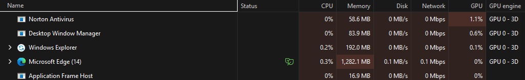

@SoulAsylum Has Norton 360 updated to v26.5.20995 on your system yet? I received this update yesterday (June 2). The “model_host.exe” file is dated June 2, 2026 after the update. I have no way of checking to see if that file was present before the update. All I know is that prior to the update, Norton 360 was reporting GPU usage for “nortonui.exe”. After the update, GPU usage is being reported for “model_host.exe” instead.
Next PVR does not task the GPU when running as a background service/process. The screenshot I provided previously shows there is zero percent GPU usage for the Next PVR processes. Next PVR does use the GPU when recording OTA content. But that was not happening at the time of the screenshot.
I am also aware that Edge and other processes use the GPU. But Edge usage is only 0.1% unless I’m watching a video on YouTube. The only other processes that use the GPU (according to task manager) are the Desktop Window Manager and Windows Explorer. But usage for those processes is only .5-1% when sitting on my Edge home page. Usage by Norton 360 exceeds both of those when Edge is Active.
As for your assertion that the 1-2% GPU usage by Norton 360 “… alone isn’t enough to force hardware to make itself spike to the point a system runs hot”, it does appear to be on my system. The GPU in my system typically ran at 37-39degrees Celsius when using Edge prior to the update from Norton at the beginning of May. My fan profile is set to start ramping up the fans when temperature exceeds 40degrees Celsius. The 1-2% added load from Norton seems to be enough for that to happen. If I temporarily disable Norton antivirus, temperatures remain below 40 degrees Celsius when Edge is active. As soon as I enable it again, temperatures exceed that threshold and the fans ramp up.
I fully understand that other processes (and Microsoft AI) use the GPU. That is not the issue here. The issue as I see it is that for some reason Norton 360 is now using the GPU (whether it is Nortonui.exe or model_host.exe) when there is no reason for it to be doing so. Is it because of new AI features that have been baked in to the latest versions of the Norton 360 software?

I did contact Norton support team. And they said, “The new update from Norton uses GPU to accelerate virus scans.”
I think this is totally dumb and no antivirus should ever use GPU for these tasks. It just means the software is not properly optimized if it needs dedicated GPU to do such regular tasks.
The main issue is with laptops because on battery power this unwanted “feature” causes huge battery drain. nortonui.exe constantly uses dedicated Nvidia GPU and there is no way to shift it to Intel iGPU (tried all methods…doesn’t work). They don’t want us tech-savvy users to change this behavior.

If you check Task Manager, after every 3-4 seconds, the GPU % spikes a bit and power usage keeps going to ‘very high’ for one of the Norton Antivirus processes (this must be the model_host process that they introduced). And this causes a significant impact especially on laptops when on battery power.
According to what I read model_host.exe only runs on systems that have a GPU that is AI capable. So it would appear that while some users don’t see this and others do is hardware specific.
