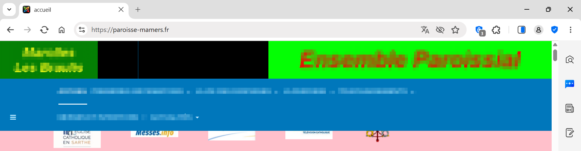

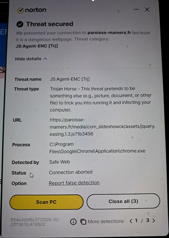

Hello, i am working with an online site:https:paroisse-mamers.fr and recently we have numerous detections and annotations like these ones: js:Agent-Enc[tr] but it’s impossible to make screen capture of this notification…
When we worked for the same data with a local server xampp there are no problems and all is working well.
i had to reduce the protections of this pc : désactivating web secured navigation in order to have something working well on the on line site.
Perhaps it’s a matter of js scripts which may be could be too ancient? I don’t know…or it’s a false-positive notification…
i am waiting for your answers and advices in order to solve this problem.
Thank you in advance for your answers.

954e3ddf6c27/2026-02-20T18:15:47.950Z
08d70d30eec1/2026-02-20T18:15:50.987Z
07f8954cc5d3/2026-02-20T18:15:53.148Z

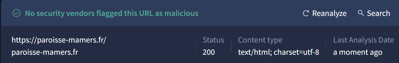

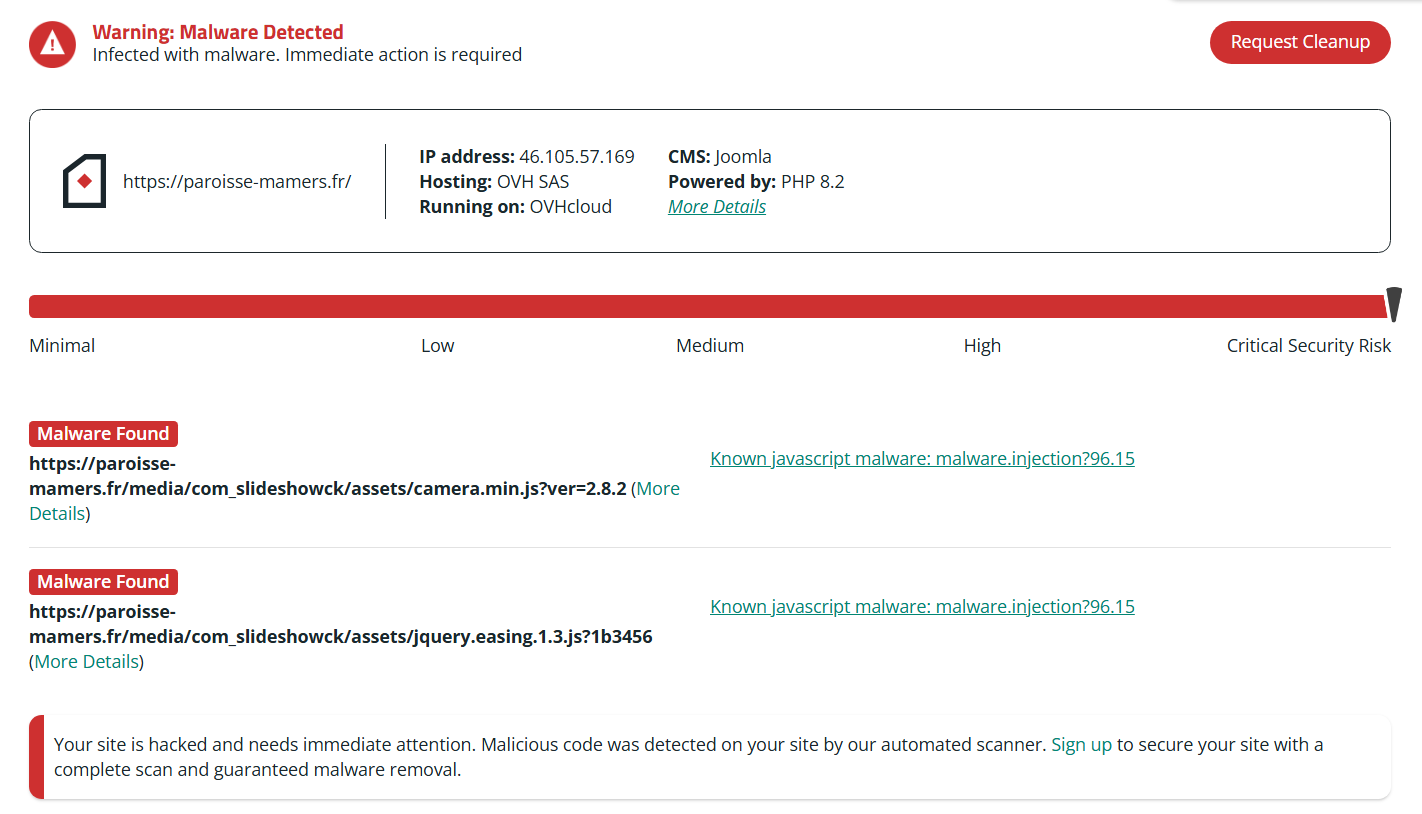

https://paroisse-mamers.fr
https://sitecheck.sucuri.net/results/https/paroisse-mamers.fr
https://labs.sucuri.net/signatures/sitecheck/malware.injection/
https://www.virustotal.com/gui/url/ca6ae992fa5a6415b1f703989f96da026aa1cef5ea5971142705b4bcf349ab16
https://www.abuseipdb.com/check/46.105.57.169

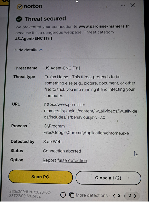

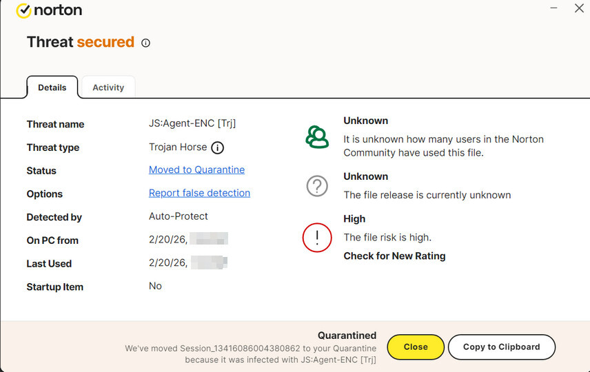

Threat name: JS:Agent-ENC [Trj]
Threat type: Trojan Horse - This threat pretends to be something else (e.g., picture, document, or other file) to trick you into running it and infecting your computer.
Status: Moved to Quarantine
Options: Report false detection
Detected by: Auto-Protect
On PC from: 2/20/26, 1:33 PM
Last Used: 2/20/26, 1:33 PM
Startup Item: No
Unknown
It is unknown how many users in the Norton Community have used this file.
Unknown
The file release is currently unknown
High
The file risk is high
Activity
Path | Type | Status
C:\Users\user\AppData\Local\Google\Chrome\User Data\Default\Sessions\Session_13416086004380862 | File | Repaired

Run a Remote Scan: Use Sucuri SiteCheck or VirusTotal on your URL. These tools can often pinpoint the exact line of code or external script causing the alert.

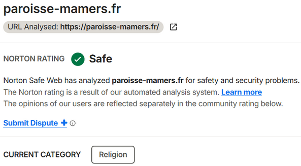

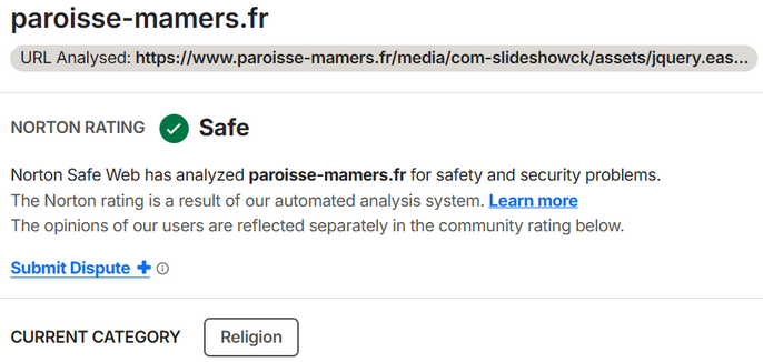

Norton 360 Safe Web engine reports JS:Agent-ENC [Trj]
Norton Private Browser Web Shield is quiet
Norton Safe Web extension reports Safe

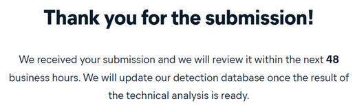

Hello, i submitted for dispute and review to Norton. I am waiting 48 hours.
Thank you for all

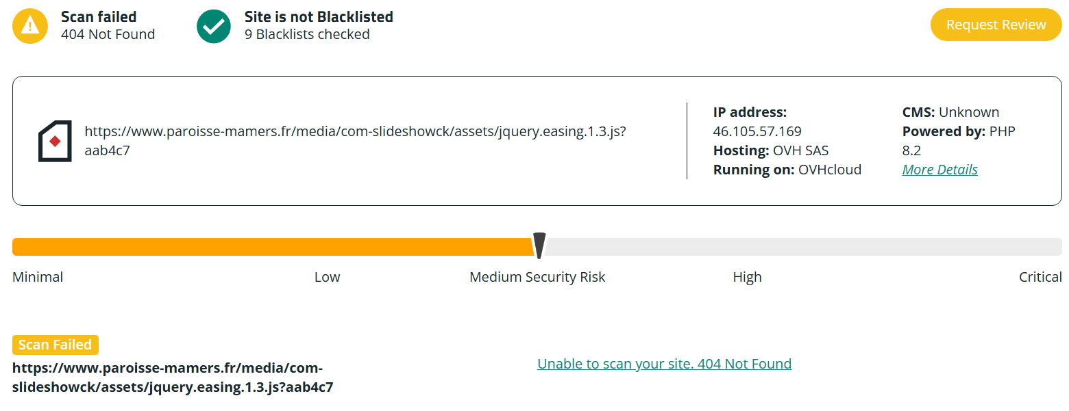

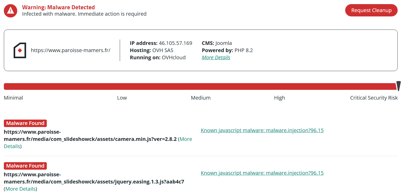

https://www.paroisse-mamers.fr/
https://www.paroisse-mamers.fr/media/com-slideshowck/assets/jquery.easing.1.3.js?aab4c7

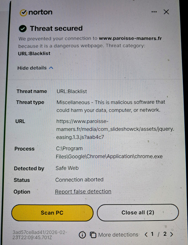

3ad57ce8ad41/2026-02-23T22:09:45.701Z
360c390df1d1/2026-02-23T22:09:58.245Z
404 Not Found
This usually means SiteCheck found a broken link on your website. Please check the URL specified in the SiteCheck results and try to fix it on your web pages.
https://sitecheck.sucuri.net/results/https/www.paroisse-mamers.fr
Hello, thank you for the errors that you gave me; i corrected the inserted malwares downloading the original files from the archives of the components or plugins. Thank you for all; Don’t hesitate to send me other errors that you could detect. Thank you for all. Jean Luc Ferré
