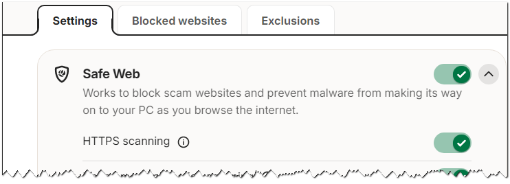

The key finding was that the affected websites immediately started working when I disabled HTTPS Scanning under Safe Web.
With HTTPS Scanning enabled:
Wise(.)com hangs during loading
Cloudflare websites fail to load properly
With HTTPS Scanning disabled:
- All affected websites load normally
While testing Wise, Chrome’s Developer Console showed the following error:
Failed to execute ‘postMessage’ on ‘DOMWindow’: The target origin provided (‘(https://)challenges(.)cloudflare(.)com/’) does not match the recipient window’s origin (‘(https://)wise(.)com’).
This makes me wonder whether Norton’s HTTPS inspection is interfering with Cloudflare’s challenge/verification process.
For now, my workaround is to leave all other Norton protections enabled (Smart Firewall, Intrusion Prevention, Auto-Protect, etc.) and disable only HTTPS Scanning.
