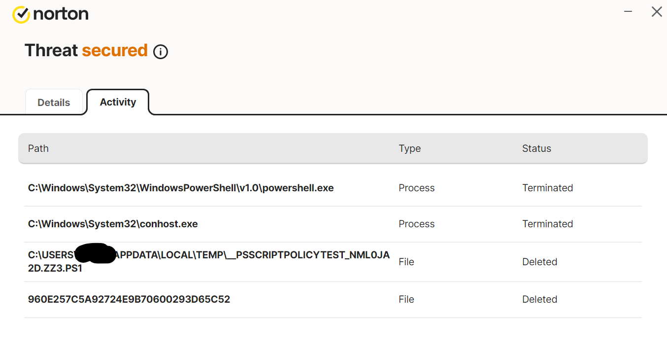

When attempting to load an application “Play Your Damn Turn” (a hotseat computer gaming application), I receive a message from Norton stating that “IDP.HELU.PSE45 - command line detection” has infected powershell.exe and Norton’s Behavior features refuses to allow the program to run.
Detailed description: See below images. Need to resolve the issue.

Threat secured
We’ve blocked powershell.exe because it was infected with
Any help is greatly appreciated. Google searches did not reveal this file as being a threat, even though Norton says it is 8 months old. I would like to get this resolved without bypassing virus protection, as my laptop has too much sensitive information it for me to take the risk.
This is also happening to me now. Any update?
All: Since this game is played by passing saved files around there is no wonder this is being detected. Files can be edited then downloaded by others to their devices and walla!! What an avenue to infect. Norton did stop the powershell infection and removed the offending file as it should. That being said if you have the file still around I would submit it to VirusTotal for them to review.

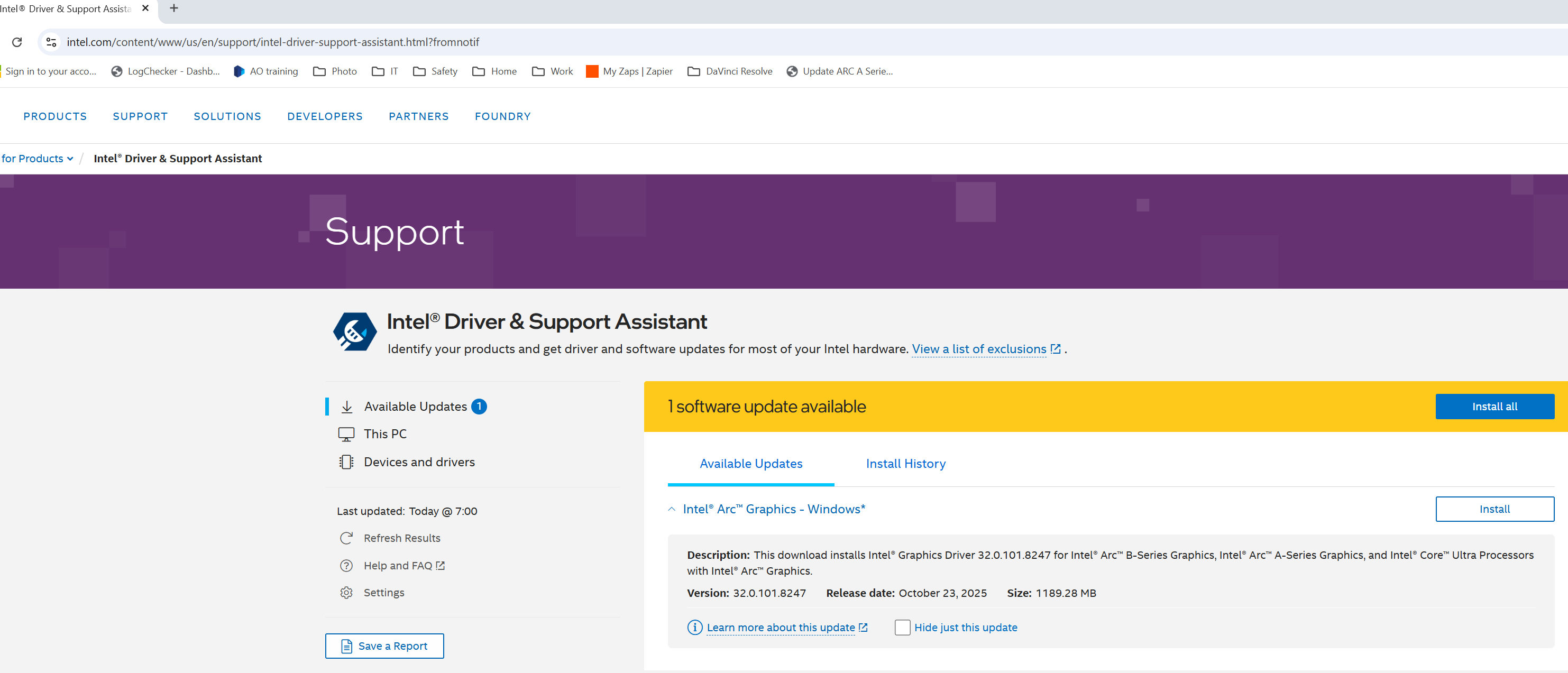

Having similar issue with intel driver update IDP.HELU.PSE53
Happening to others also on the community intel site.
Der er 4 major bugs fix i 25.10 i norton 360 der er omkring det så hvis du har den skal du regne med at dine fejl er fiks jeg ved vad kommer i 25.11 og det er også 3 mega fejl bare så du ved det men det er ikke den type fejl det er mere 3 blandt fejl men som også er store og du skal glæde dig til den
@BlakeA_Edwards Where are you downloading this update from? Intel or your OEM website? What is the driver name? TIA.
From intel driver support. Have never had an issue It only been this last update.
filename is : gfx_win_101.8247.exe
https://community.norton.com/t/intel-arc-graphics-windows-10-23-2025-a580-unable-to-install/460675

Edited: Have you checked Windows settings for Core Isolation being enabled?
Does this Intel® Graphics Driver 32.0.101.8132 (WHQL Certified) for Intel® Arc™ B-Series Graphics, Intel® Arc™ A-Series Graphics, and Intel® Core™ Ultra Processors with Intel® Arc™ Graphics. Give you the same issues?

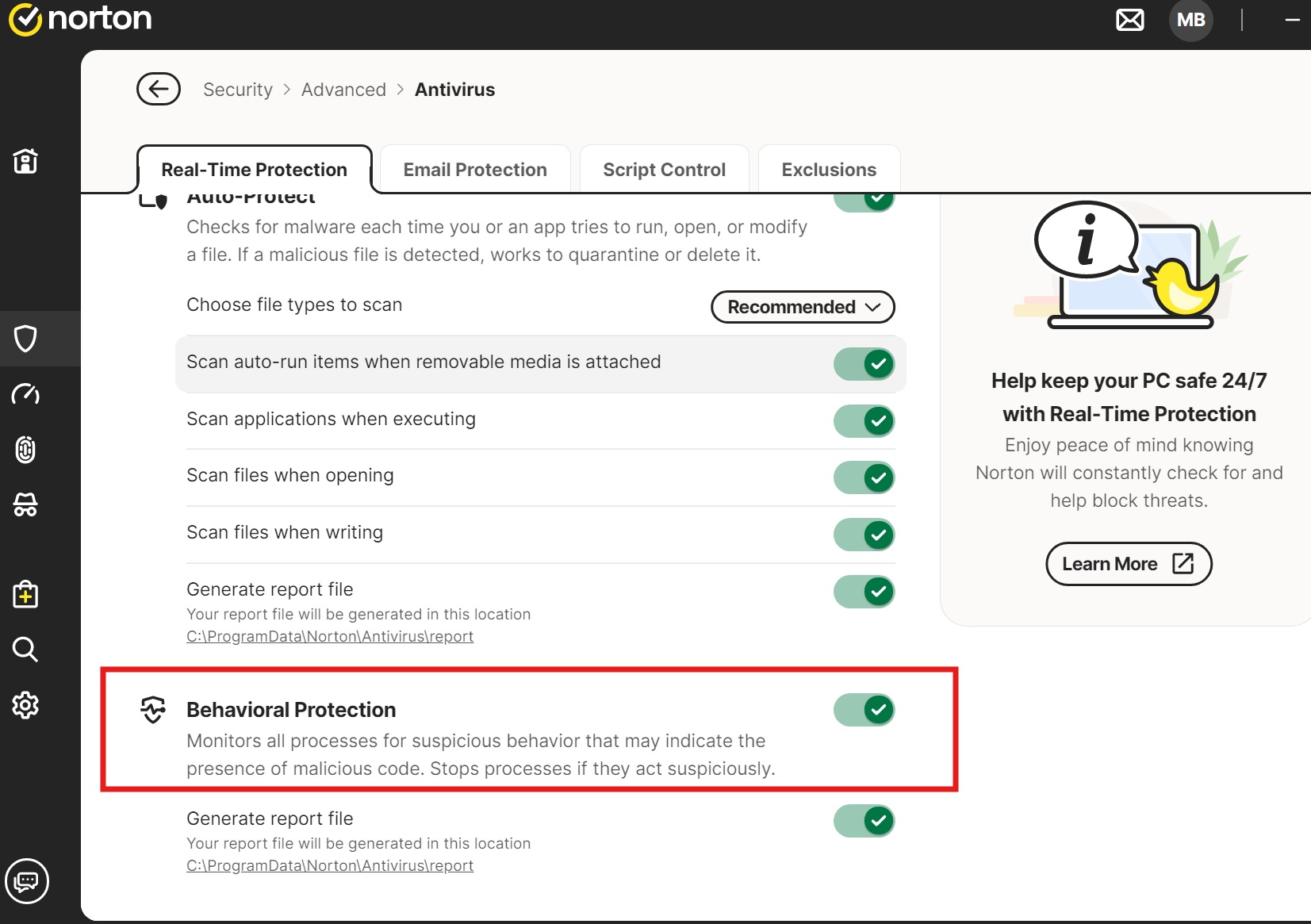

Temporarily turn off Behavioral Protection to install the driver.
https://community.norton.com/t/intel-arc-graphics-windows-10-23-2025-a580-unable-to-install/460675/5
~ adding: for users that pass this way
Auto-Protect disable does not disable Behavioral Protection
https://community.norton.com/t/intel-arc-graphics-windows-10-23-2025-a580-unable-to-install/460675/6
https://community.norton.com/t/intel-arc-graphics-windows-10-23-2025-a580-unable-to-install/460675/9
