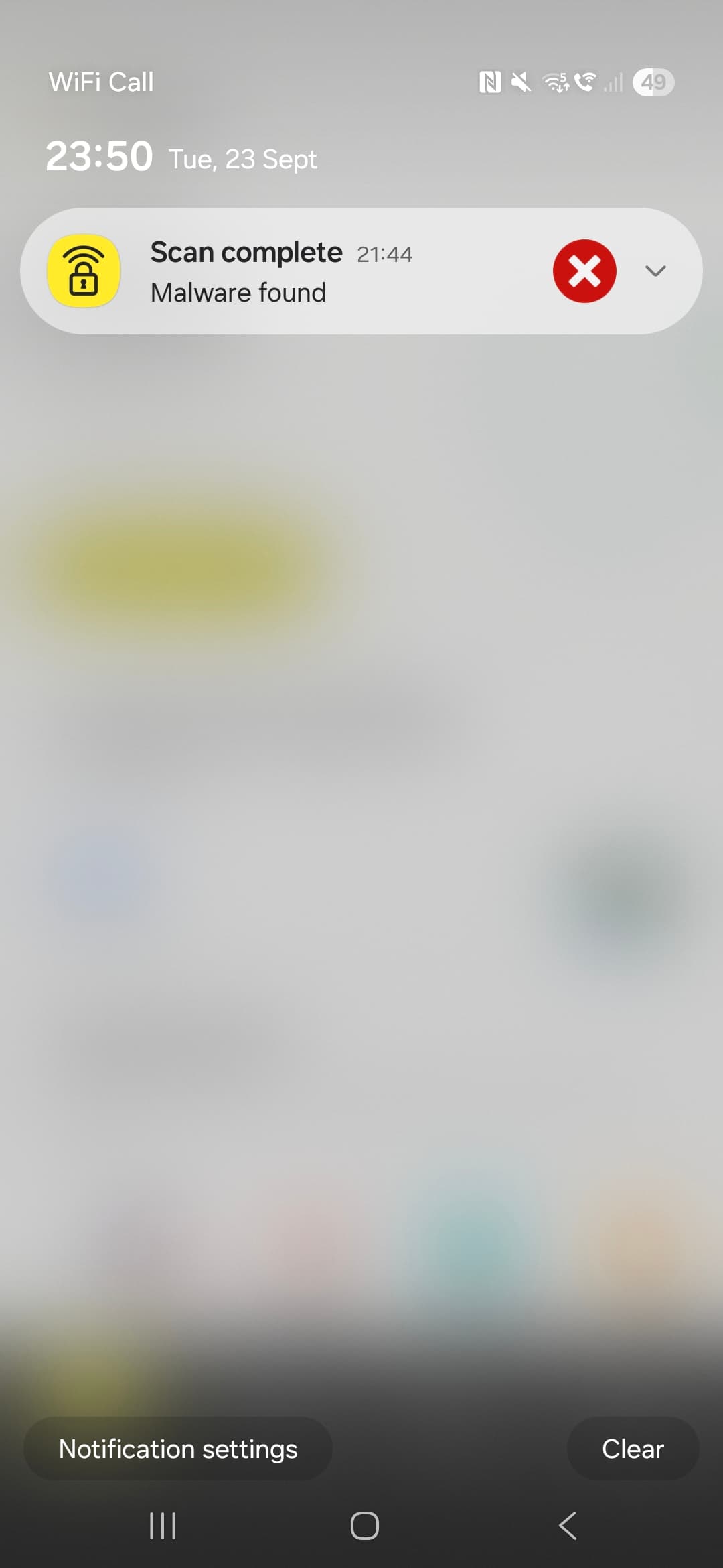

Scan Complete. Malware Found
I am getting a concerning warning notification on one of my Android S24 phones.
“Scan Complete. Malware Found”. The icon is the norton vpn icon. And there is red X.
When i click on the little down arrow it just repeats the message but no additional info. When i tap on the message it takes me to the VPN app. That shows that vpn is off because my network is secure. The ‘inbox’ has a thumbs up with no issues.

Hi @peterweb. I had uninstalled 360, shutdown, restarted a couple of times. No joy. I then uninstalled the standalone vpn. Shutdown. Restarted. Checked that 360 didn’t need it and had is own vpn functionality. And all sorted. So it seems, without detailed investigation of course, that norton 360 was finding the standalone vpn a problem. Thanks for all your input.
Good diagnosis. Thanks for posting back.
This is an example of why it is not recommended to have both 360 and the standalone VPN app installed on Android. It can cause conflicts and strange behaviour, as you found out.
