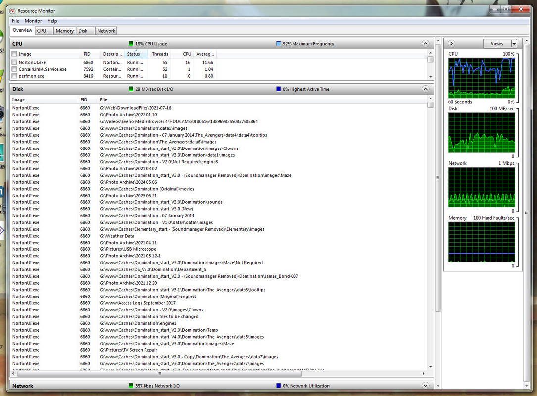

PS Unable to upload photo showing all instances of NortonUI.exe in Resource Monitor - says there is an error !!!
Hello @user2850
Direct link > paste… works for me…may not work for you
for example:
I hope this is the image. I see it worked…
Curious, what’s (G:) internal or external drive?
I have 2 Seagate 2TB drives, a 256GB M2 card (C: Windows), 2 SSD’s each 512GB and 2 DVD’s – all internal.
Split into partitions C, D, E, F, G, H, I, J, K, L, M, N.
G is where a lot of my data is stored, including years of photos.
N is a cloned backup of the OS for disaster recovery.
At the present time 4 of the partitions are empty. Had to delete many of the backups to cut down the time Norton was taking scanning the drives.
I just want to stop the scans Norton does at startup – if I can’t do that then my only alternative will be to remove Norton and get something else.
