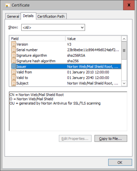

I then selected and viewed the “Norton Web/Mail Shield Root” certificate and it can be seen that this is a self-signed certificate created by Norton …

and confirmed that the same “Norton Web/Mail Shield Root” certificate was present in the ‘Current User’ and ‘Local Computer’ ‘Trusted Root Certification Authorities’ certificate stores. Presumably added to those trusted root certificate stores by Norton 360.
That would normally mean the ‘mail.btinternet.com’ certificate should be trusted but it clearly isn’t.
