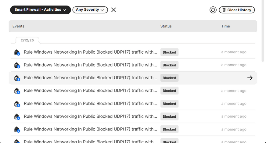

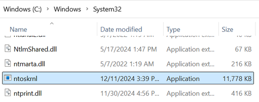

@bjm I have one more ask. No hurry but when you get a chance, would you look for PID 4 on the list in your TaskManager’s Detail. When I looked over the netstat -aon results you posted for me the other day, there were only two UDP events using ports 137 and 138. They both were related to PID 4. It’s only a hunch but those may be the processes triggering UDP(17) in N360. In my Task Manager, PID 4 is a Windows system process.

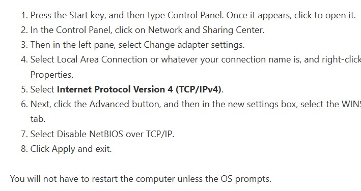

I’m not seeing any UDP traffic using ports 137 - 139 on my computers. The reason may be because I have netBIOS disabled in all my computers, as I mentioned before. My computers are running Win10 but the process for disabling netBIOS is the same on Win11. It would be interesting to see if disabling netBIOS in Windows will stop UDP(17) events in N360.
I posted directions on disabling netBIOS last week on one of the N360 threads but can’t find it. Here it is again. https://www.thewindowsclub.com/enable-or-disable-netbios-over-tcp-ip-on-windows-10

A how to fyi for those interested: * Note that in earlier posts we talked about LMMNR and how it coupled with NETBIOS may be what Norton is trying to log.

@Puzzler – I’m just trying to be helpful. I see PID 4 on the list in my Task Manager’s Detail tab. Here’s a snap shot for you.
PID 4

Great! So at least for now it looks like disabling NetBIOS in Windows stops the annoying Blocked UDP(17) event logs in N360. Thank you for being willing to experiment. Since I’m still using V22, I had no way to check my hypothesis.
UDP(17) “Allowed” alerts are helpful since NetBIOS poses a potential security risk but the value of incessant “Blocked” notifications is questionable. Hope Norton will tweak this in a future release.
Another “ask” for Norton is that it provide more information on the source of alerts (either through the GUI or support pages) to eliminate the need for our detective work and make N360 more user friendly.
Thanks again, BJM.
If your UDP(17) alerts are showing up as Blocked and your system is working, then there’s no concern. That said, maybe disable NetBIOS in Windows to be on the safe side.
As you note, this was a winding path for sure. My goal in chasing this down the rabbit hole was to find the source of the numerous UDP(17) events popping up in N360’s Security History. The sheer number of events logged seemed excessive. The first step was to eliminate N360 using ports 137-139 for UDP traffic, which @BJM and I did. Next was to confirm that the source was a Windows process. Since UDP(17) is a protocol for networking and those events weren’t showing up on my computer before reverting to V22 from V24, I had a hunch that disabling NetBIOS in Windows might be the answer. NetBIOS has long been known to be a potential security risk in Windows, so one of the first things I do when I get a new Windows computer is to disable it.

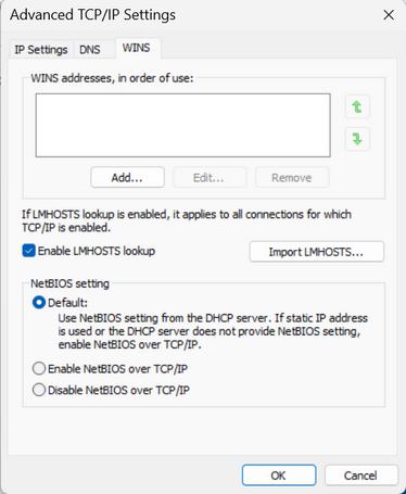

NetBIOS setting → Default:

just posting that NetBIOS setting → Default: triggers UDP Blocked
