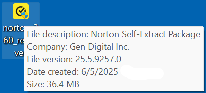

File: norton_360_remover.exe
File size: 36.5 MB (38,251,008 bytes)
MD5 checksum: D2D4F1B27B27A483EFFFBC8C339F7C03

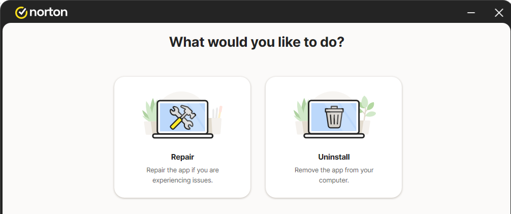

NRnR.exe version: 4.5.0.231 presents the same…Thank you for choosing Norton 360…dialog window as norton_360_remover.exe version: 25.5.9257.0

Note: with Norton 360 v25 removed. Windows Security running.
Norton Remove and Reinstall tool v4.5.0.231 calls
Norton 360 Remover tool v25.5.9257.0 calls
