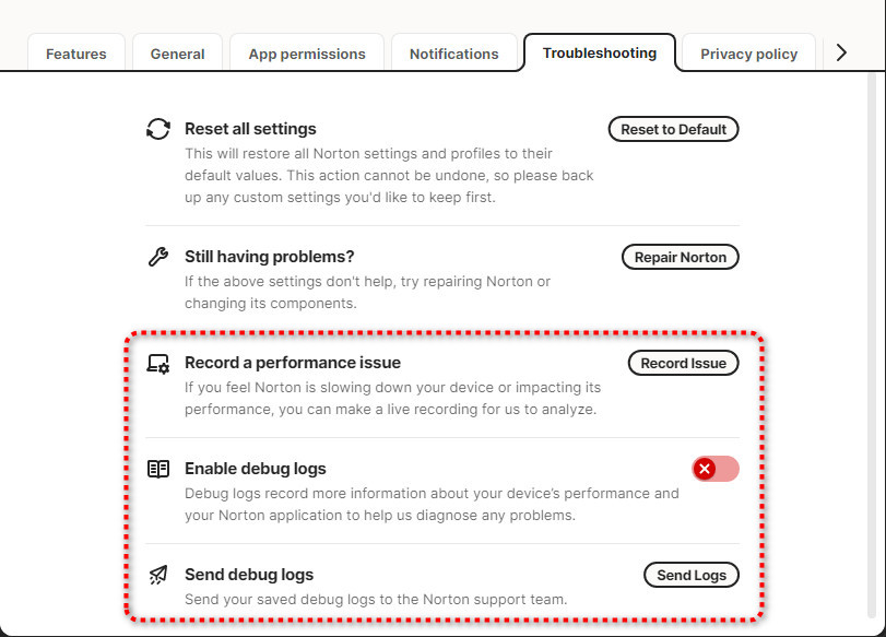

Maybe, try Troubleshooting → Record a performance issue &or Enable/Send debug logs

Ich now have activated the debug logs and try again to run a local backup. But after clicking on “create backup” I only see the window telling “no local backups created” and with the “create local backup” button.
I now will send the debug logs

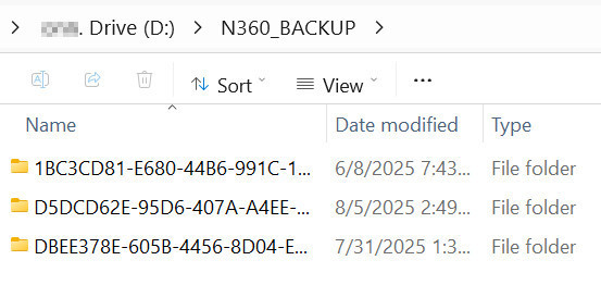

And you’re sure external drive has been reseated and is powered?
And you do find N360_BACKUP folder?
for example:
