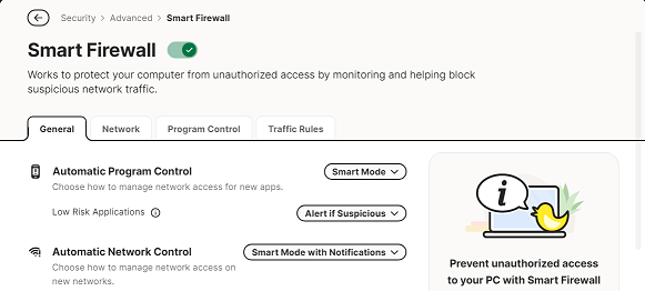

That’s all good info, but my point was that Exclusions does not work. In order to share files with other computers on a private network, you must disable File & Printer sharing protection completely.
why are you adding exclusion to Intrusion Prevention?
and your Private Network settings are default?
and your Automatic Network Control is Smart Mode with Notifications?
and you tried Smart Firewall → Restore default settings?
any Blocked devices?
I need to add exclusions for local machines on my private network in order to share files between them. Otherwise the setting under Remote Access Protection for File & Printer sharing will block ALL File & Printer sharing. This was not necessary in v22. I’m fine with a more comprehensive and strict environment, but at least make it work as designed.
My Private Network settings ARE set to their default, I have not touched them.
Automatic Network Control IS set to Smart Mode with Notifications.
I’m not willing yet to restore default settings because I manually manage ALL program access and spent a considerable amount of time setting that up
