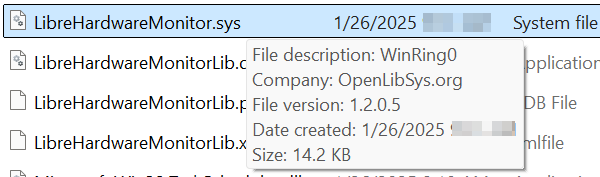

I am trying to allow one single file; <LibreHardwareMonitor.sys> to run, but is blocked by Norton.
Is there any way to get Norton to accept/ignore the file without turning of “Block vulnerable kernel drivers” thus making me more vulnerable? i just want that single file to run just like it did before the “UI revamp-update”.

Vulnerable Drivers:
Drivers are small programs that allow the operating system to interact with hardware devices; if a driver has known vulnerabilities, attackers could potentially exploit them to gain unauthorized access or control.
Developers: Noriyuki MIYAZAKI
Version: 1.2.0.5
Identified: 1/26/25
Last Used: 1/26/25
Startup Item: Yes
Many users
Thousands of users in the Norton Community have used this file.
Mature
This file was released 5 years ago.
Trusted
Norton has given this file a trusted rating.

No, I am using LibreHardwareMonitor - “LHM” for a Rainmeter skin, to get readings for CPU temp etc.
I did find a temporary solution for Norton to accept the file.
Turn off “Block vulnerable kernel drivers”
(if needed; Re-install the software and) Open “LHM” as admin and then close it again
Rightclick on <LibreHardwareMonitor.sys> and scan for virus
Turn on “Block vulnerable kernel drivers”
Now the file will be present & work, even after a reboot.
This may only work until you are doing changes to “LHM” and the .sys file may be altered? Only time will tell. But then you could try repeat the steps.
This fix only works until Norton is updating the virus database, then it breaks again and blocks the mentioned .sys file.
