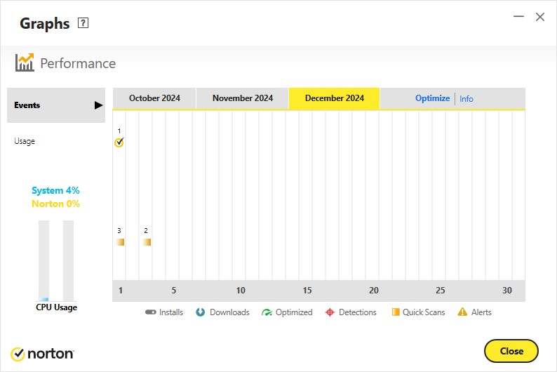

Gave the ‘Startup Scan’ a punt.
The results, dunno ?
Archive is password protected. x4
CAB archive is corrupted. x1
Installer archive is corrupted. x10
ZIP archive is corrupted. x7
Files. x925864
Folders. x303180
Ran the NPE. x0

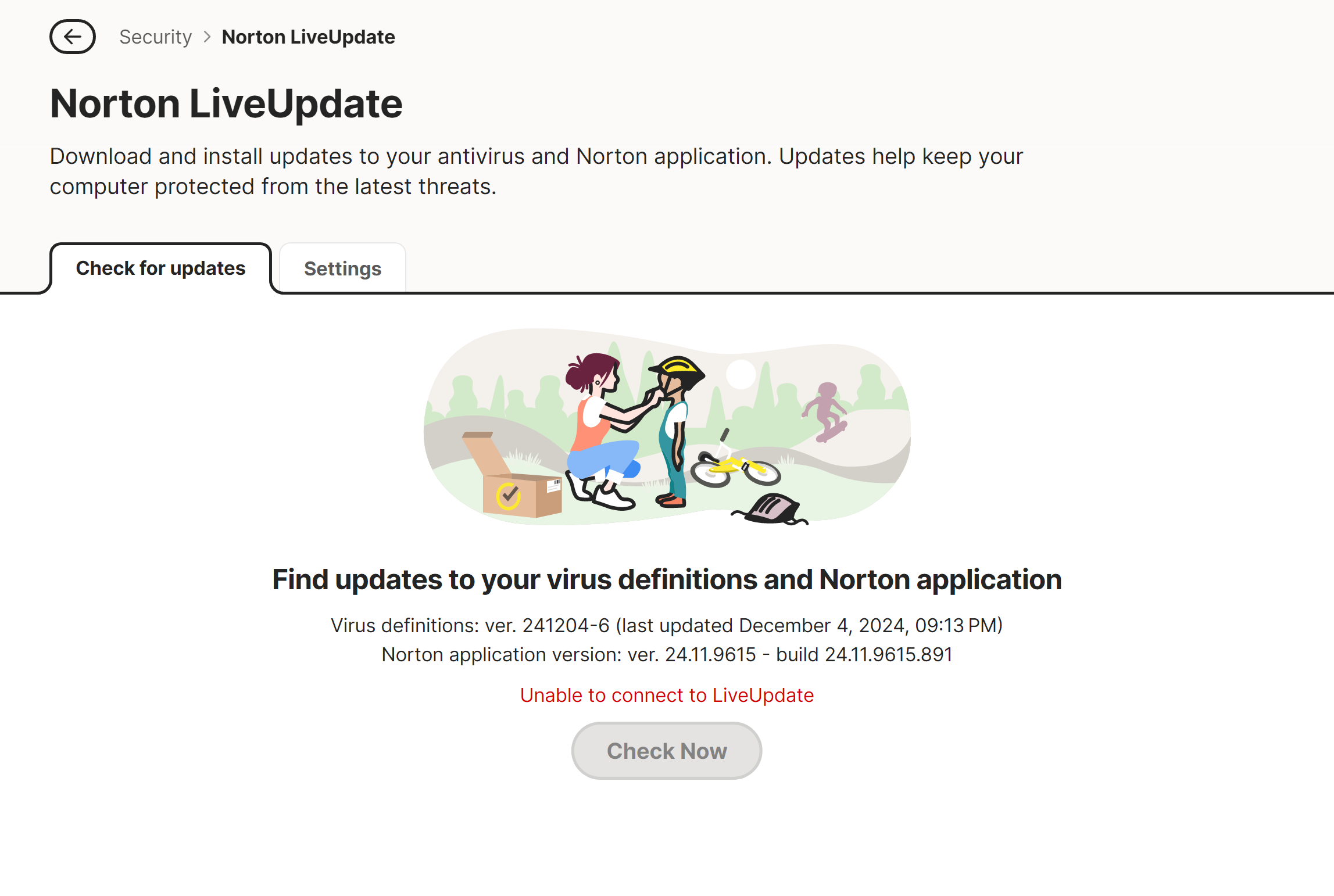

(3) Frequently unable to run LiveUpdate because it cannot find an internet connection, yet I do have internet and the rest of my system appears to access the internet fine.

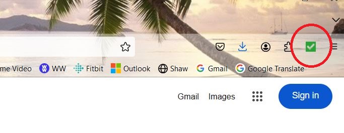

Norton Safe Web
Is it just me or has anyone else noticed it is back and working in Firefox? It was my understanding that Norton Safe Web would no longer be working in Firefox and would only work within Norton Safe Search (which I do not use) and indeed it was gone for at least a week. However, I just noticed the other day that it is back again. Has Norton had a change of heart or what?

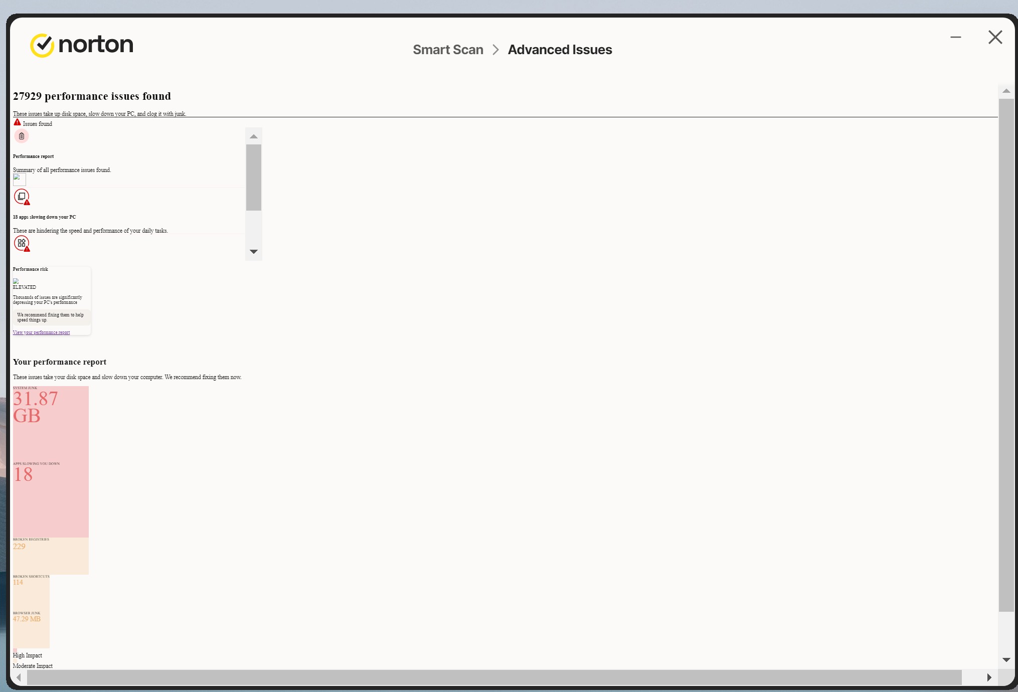

Knock knock Norton. Any update on this POS upgrade? Why can’t we go back to the previous version and stay back until you fix this crap?
Will all these issues, the front end must be embarrassing as well. Look at my screenshots:
